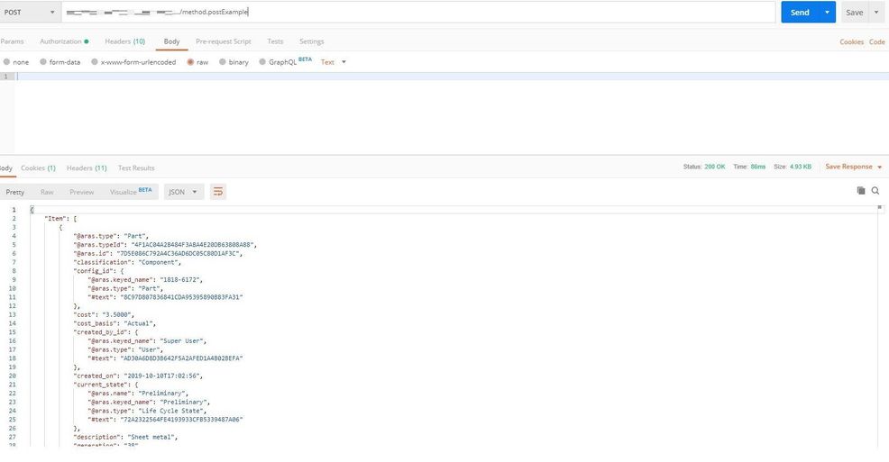

Now that we have a method to call, let’s create a simple POST calling postExample. Once we send the request, all parts with owned_by_id set to the Administrators Identity will be returned in JSON form. The link should be as follows:
POST {base url}/method.postExample
If you scroll down the response, you will see that owned_by_id is in fact the Administrators Identity for each part returned.
"@aras.keyed_name": "Administrators",
"@aras.type": "Identity",
"#text": "2618D6F5A90949BAA7E920D1B04C7EE1"
If we go to the parts we created within Aras Innovator or run a quick AML query, we can see that they will match the returned results.
