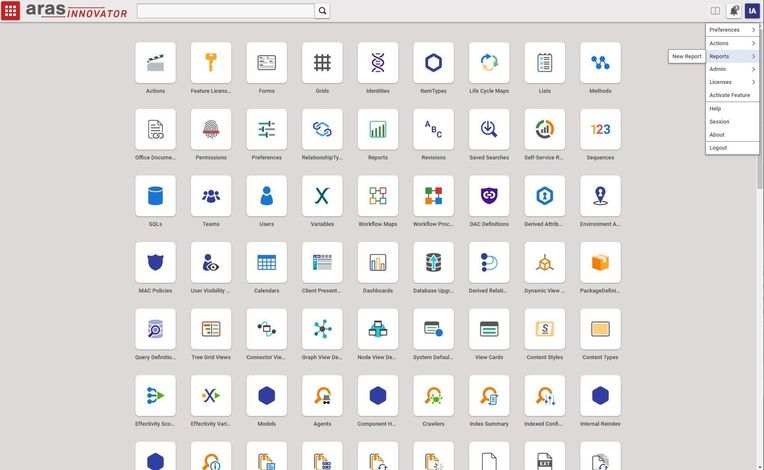

1. The first task we will perform is opening up the User Menu icon.
2. Select Reports, then New Report as depicted:

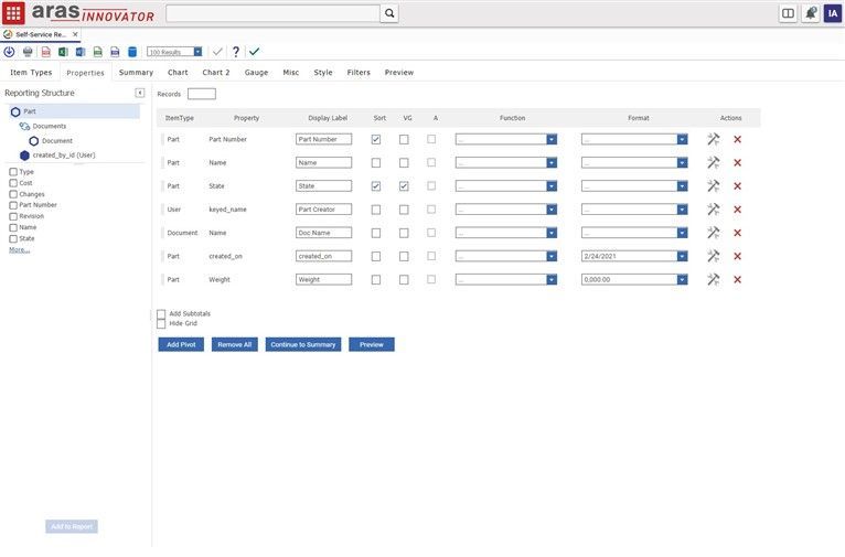

7. Within this section we will select the following properties and fill in the details as shown below.
8. We can choose properties from the Structure table on the left, note some may be hidden so you’ll need to click the More… button to see all of them.

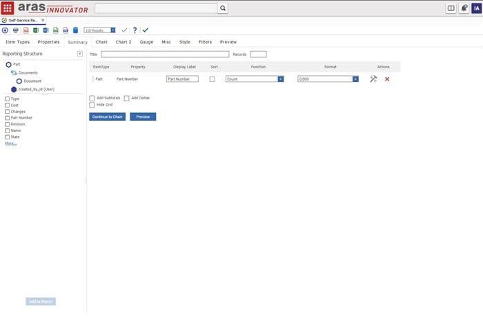

9. Moving on to the summary section, click the button labeled Continue to Summary below and then add a count for the Part Number property. This is what it will look like:

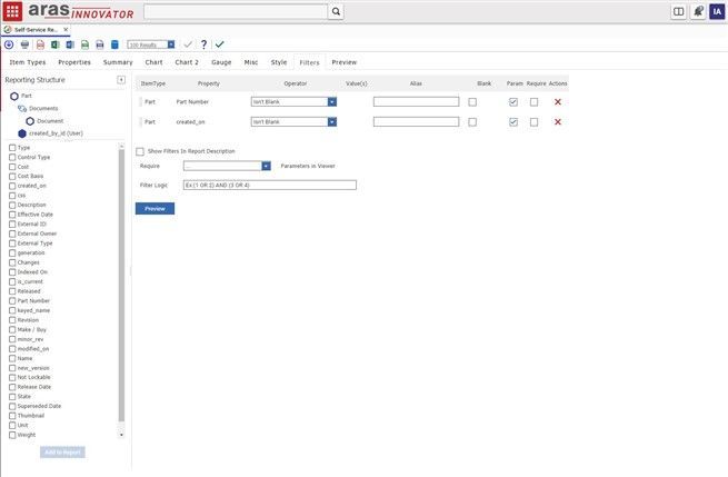

13. Wrapping up we will add filters for the Part Number and created_on properties. Click the Filters tab and add the following properties:

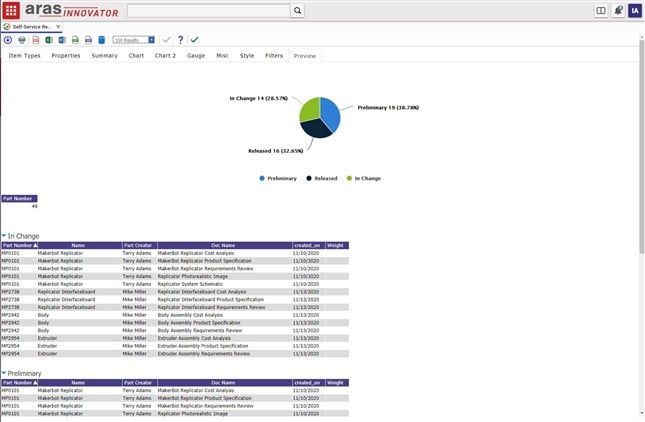

14. Clicking the Preview button below will generate our report, we can see the results are displayed on the Pie chart! You should also see tables containing the actual data for each state, In Change, Preliminary, and Released parts.
At the top you can further adjust the number of results displayed within the tables, export to other formats such as excel, CSV, PDF, etc.. Note there are a few more tabs we did not cover in this blog post such as the Style configurations which allows further customization of headers, colors, order, and more!
