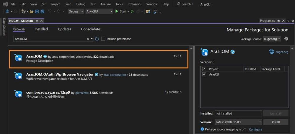

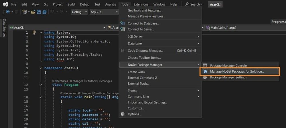

  2. In Solution Explorer, right-click your project and select Manage NuGet Packages for Solution.
  3. In the Browse tab, search for Aras.IOM
  4. Select the package published by Aras Corporation and choose Install.
  5. Accept any license prompts.
That's it! No more copying DLLs by hand. You can use the package manager to check for updates and install the latest Aras.IOM release in your project.

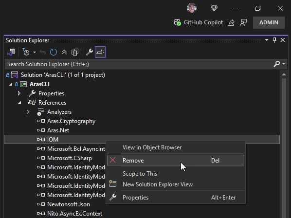

If you’re upgrading an existing project that has a hardcoded IOM.dll reference, here's how to switch over to the NuGet package:
  1. Remove the old reference:
    • In Solution Explorer, right-click the Iom.dll reference and select Remove.
  2. Add the NuGet package:
    • Follow the same steps above to install Aras.IOM from NuGet.
  3. Rebuild your project:
    • The namespace and classes remain the same, so no code changes should be required.
