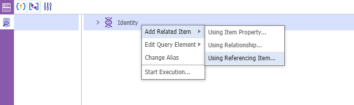

Once we're in the editor, we can start building out our query. We can right-click on the root Identity node of our definition and select Add Related Item > Using Referencing Item... .
Selecting this will bring up a dialog that contains a list of all of the item properties with the Identity ItemType as the data source. For our example, we'll be looking for the item labeled Member (Has Member). This means that we'll be adding a reverse lookup to the Member that exists between a Group Identity and the Identities that make it up. The name in parentheses, Has Member, is the label of the property. In this case, Has Member is the label of related_id.

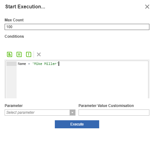

To test our query, we can run Actions > Execute Query from the toolbar of our Query Definition tab. This will bring up a dialog that lets me enter some additional criteria to filter the query. I'll choose to run this query just against Mike Miller, so I can more easily compare the results to what my membership report returned.
