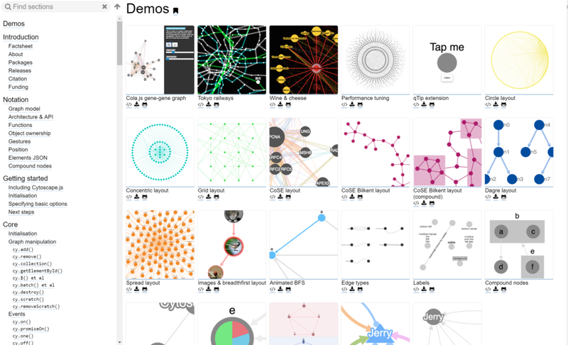

The graph library: Cytoscape
You could use other graph libraries, it's just that I've been used to play with cytoscape. The webpage has a lot of sample and if you follow this project you will see that it is well maintained and active.

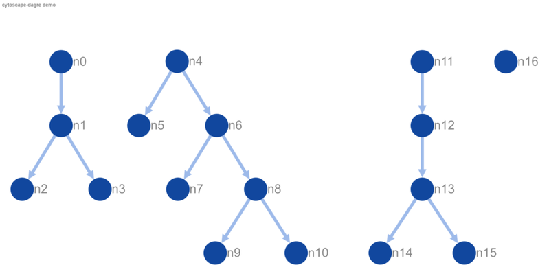

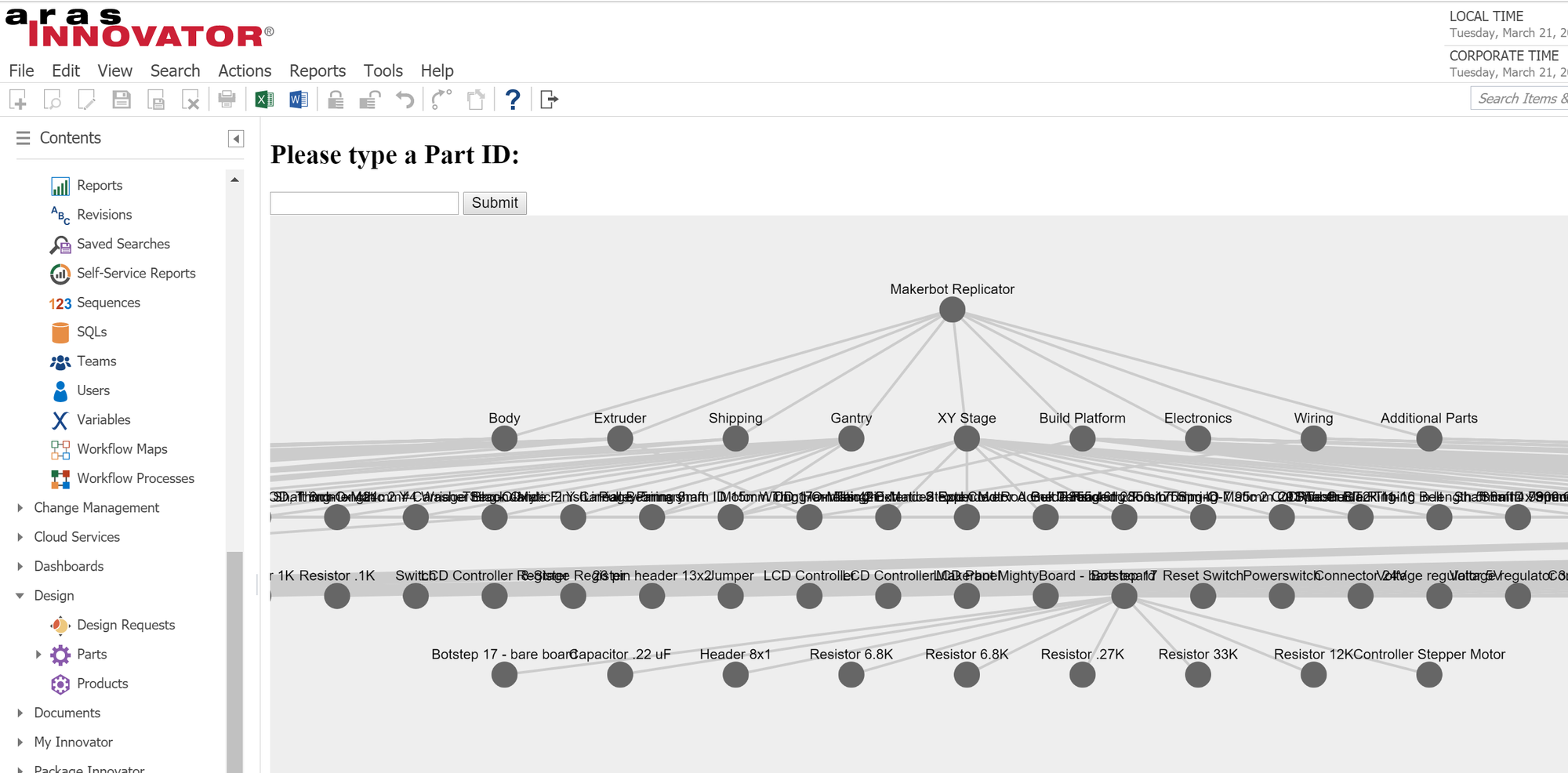

In this tutorial I want to get something pretty similar to the following picture where at the top I would have the selected part and then I would show the whole BOM underneath it.
It is all developed client side (javascript) and the typical data you send to the graph library to add nodes and edges is the following:

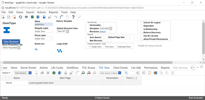

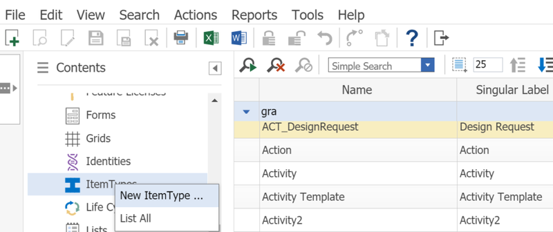

The graph could potentially be started from a context menu but for this tutorial I'll use a TOC entry.
  • Create a new ItemType
  • Add a Toc Access and a Toc View targeting the script file that we will add to our filesystem (here in innovator/client/scripts/custom/graph/index.html)

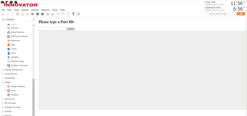

Now that we know we can get the data, we will provide the interface for the user to type a part Id and a place to show the graph.
Here is the new body Tag :
<body>
<h2>Please type a Part ID:</h2>
<input id="partid" type="text">
<button onclick="createGraph()">Submit</button>
<div id="graph"></div>
</body>
and we add some CSS
 #graph {
width: 100%;
height: 500px;
background-color: #EEE;
You should get this :

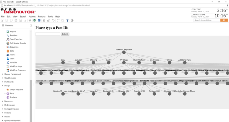

And here is the result !
