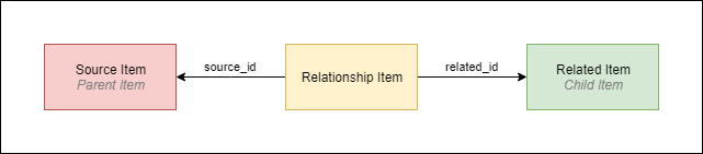

In this post, we'll use the following terms to describe the Aras data model.

Definitions
