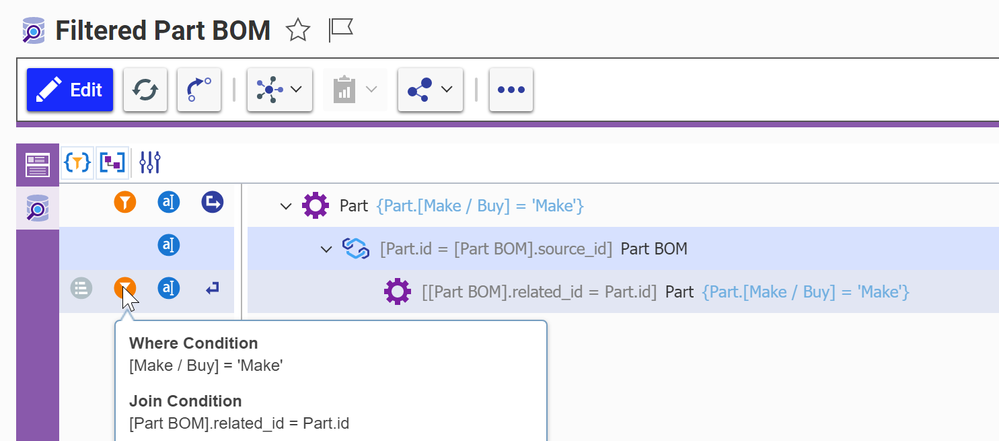

Recently, I wanted to take our standard EBOM and filter based on the make/buy property. I only wanted to show make parts, and hide the buy parts. I took the standard existing Part BOM Query and TGV, and applied a filter to the query, which looked like the image below.

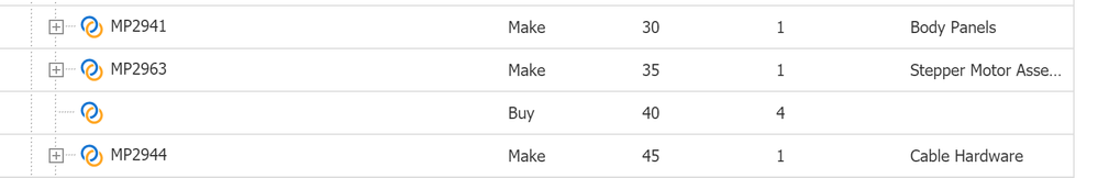

My though was that the filter would catch if either of the two combined items violated the filter. It turns out that the combined row will still be displayed, but will hide any information which comes from the filtered portion of the combination.

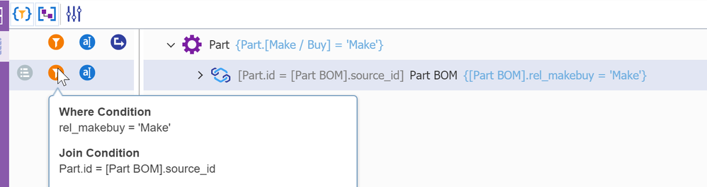

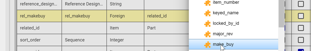

To fully filter the row, I needed to add a property to the Part BOM ItemType. Since I needed to pull this information from the part, I added a foreign property, pulling the make/buy property from the related part. Here’s what the row looks like:
I then added a filter onto the relationship portion of the Query Definition which filters based on our new property.

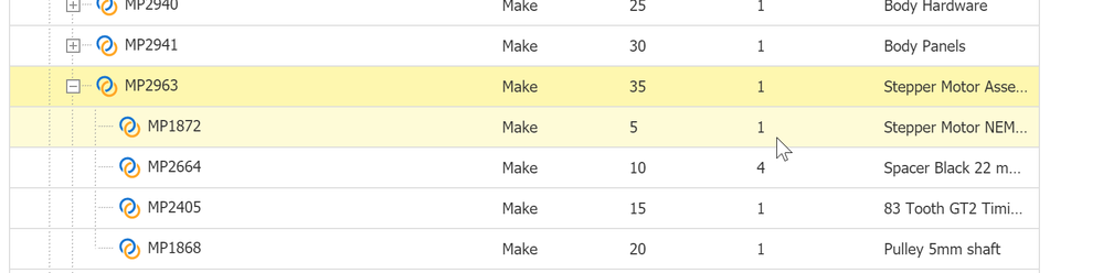

I didn't need to make any additional changes to the TGV, I can just go and see the result. The image below has the intended filter, and there are no parts marked as "buy".
