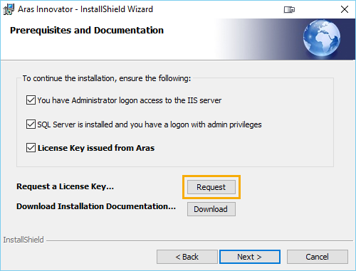

  1. Confirm and check off all items in the prerequisite checklist.
    • If you do not have an Aras 12.0 framework license for the current machine, click Request to request a framework license from the Aras website.
    • After completing the request, confirm that you have received a new framework license via the email address you provided.
    • If you have any issues requesting or receiving a framework license, please email [email protected].
  2. Click Next.

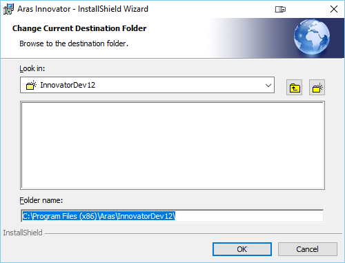

By default, the Aras Innovator installer suggests C:Program Files(x86)ArasInnovator as the root installation folder. However, we typically recommend choosing a more descriptive name for the target installation folder. This practice becomes particularly helpful in the event that you have several different versions of Innovator installed on the same server.
  1. To choose a new destination folder to use for your Innovator installation, click the Change button.
  2. Replace "Innovator" with your desired install folder name. In the example above, we've chosen to name our installation folder InnovatorDev12.
  3. Click Next.
A note about installation folder names: Stick with alphanumeric characters and underscores for your install folder names. Avoid spaces, dashes, and other special characters.

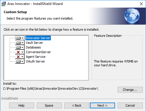

Here you're given a choice between installing either Complete or Custom. Complete installs every component of innovator, while custom allows you to pick and choose what will be useful for you. This guide will assume selection of the Complete option.
Choosing the custom option will bring you to the screen below. The Innovator Server, Vault Server, Database, and Oauth Server are important to install for basic functionality of Aras Innovator. The ConversionServer and Agent Service are related to things like PDF generation, or the import of CAD files.

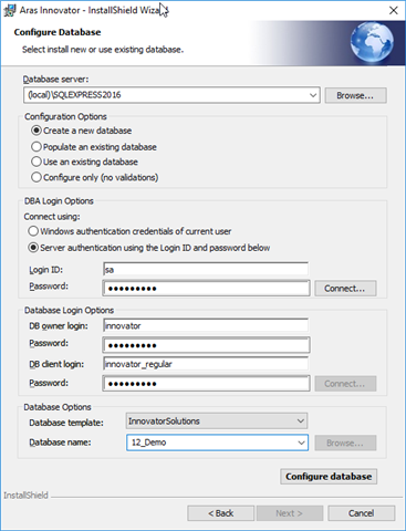

Database Configuration
  1. Click Browse to select the database server.
  2. Select the desired database server from the dialog.
  3. Click OK.
  4. Under Configuration Options:
    • Select Create a new database
  5. Under DBA Login Options:
    • Select Server authentication using the Login ID and password below
    • Enter Login ID: sa
    • Enter Password: password for sa (SQL Server admin user)
    • Click Connect...
  6. Under Database Login Options:
    • Enter DB owner login ID: innovator
    • Enter Password:
    • DB client login: innovator_regular
    • Password:
  7. Under Database Options:
    • Select Database template: InnovatorSolutions
    • Database name - enter the desired database name
    • Click Configure database
    • Click Yes to confirm database installation and configuration
  8. After database installation/configuration is complete, click Next.
