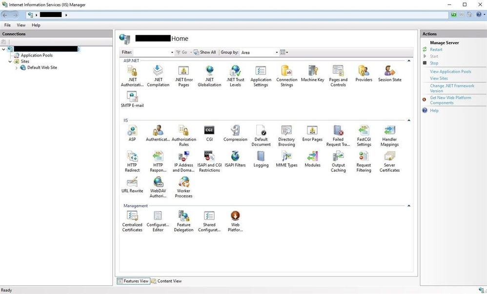

  1. Hit the windows key on your machine and type in Internet Information Services (IIS) Manager and hit enter to open the application. This is the application that will open:

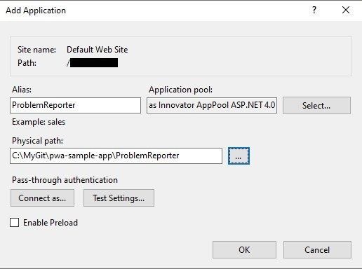

  3. Within Default Web Site dropdown right click on the innovator web alias you will be using with the reporter app and select Add Application from the new dropdown.
  4. This will bring up a popup dialog; use ProblemReporter as the new application’s alias in the Add Application dialog. This will be serve as the name of our application within the URL.
  5. Select the physical path to the git repository > Problem Reporter then click ok.

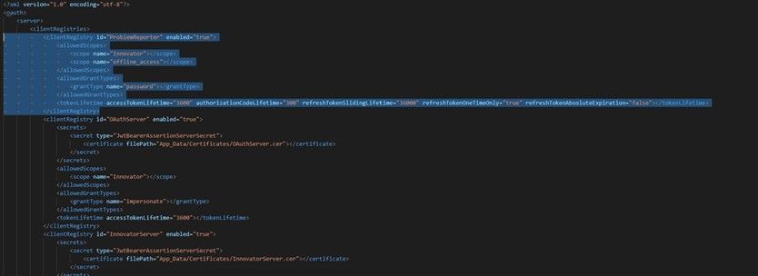

  3. Under the clientRegistries tags we will be add the following and save/close the file:
gist.github.com/.../ef19ef0b9c812f0d431a885fb8af726b
Run another IIS restart, step 6 of the IIS Configuration instructions above, before proceeding. Your OAuth.config file should look like this at the end:
