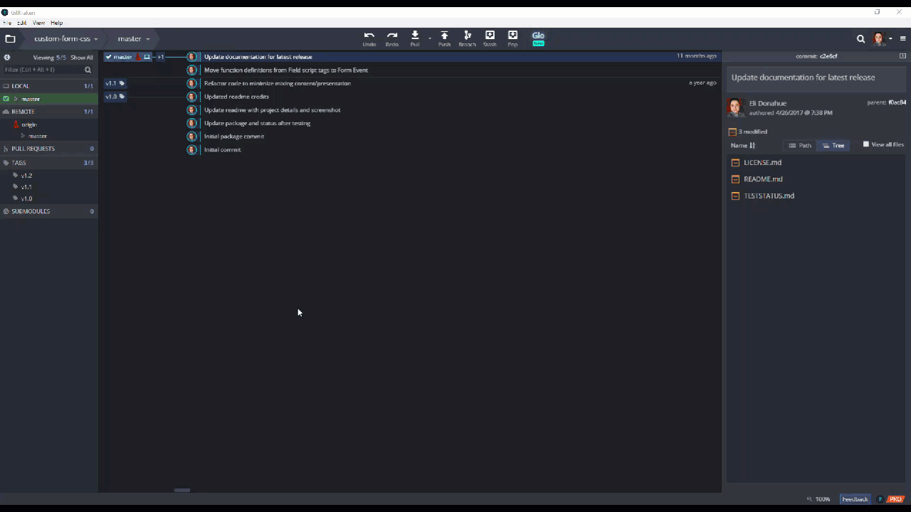

GitKraken
Steps for creating a new local repo with GitKraken
- To create a new repository in GitKraken, select File > Init Repo from the main menu. There will be several options for different types of repositories, but for this tutorial we'll keep the default Local Only selection.
- Next, choose a folder to be your new repository. You can pick an empty folder, or one that already has files in it; you won't lose your changes.
- The dialog also includes settings for default .gitignore templates and license files. We'll skip these options for this tutorial.
- Click Create Repository.

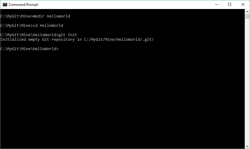

Command Prompt
Creating a new local repo with the "git init" command
- Open a command prompt window.
- Navigate to the folder you want to use as your repository. You can pick an empty folder, or one that already has files in it; you won't lose your changes.
- Use the git init command to set up the new repository.
C:MyGitMineHelloWorld> git init

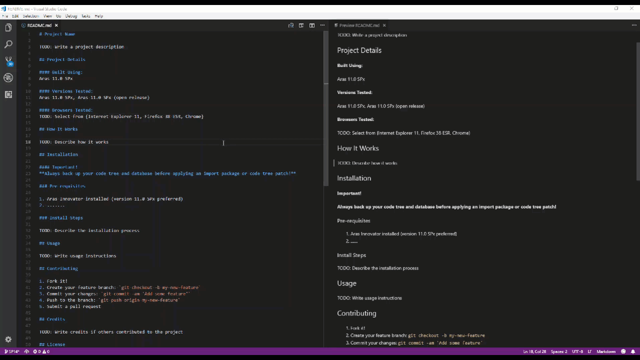

The README.md file contains the content displayed on your project's GitHub landing page. It should include basic details about your project, like a brief description, which versions of Innovator your project supports, how to install your project, and basic steps to use your project. If you need a good starting point for your README.md file, Aras Labs has provided a template you can use.
Tip: Visual Studio Code has a great side-by-side preview feature for markdown files.
Editing and previewing README.md markdown in Visual Studio Code

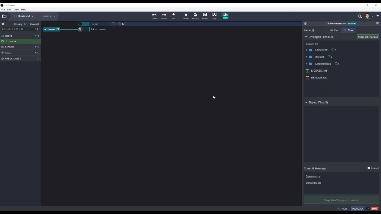

If we look at our repository in GitKraken, we will see a pane on the right side of the window with three sections: Unstaged Files, Staged Files, and Commit Message. The Staged Files section contains a list of changes that will be included in the next commit. The Unstaged Files section contains all other changes.
Stage the Changes
Right click each file or folder in the Unstaged Files section that you want to commit, then select Stage. If you want to include all changes in your commit, click the Stage all changes button.

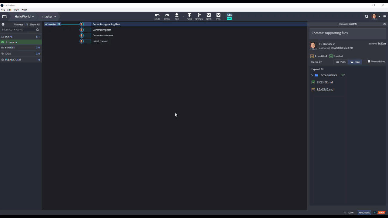

Commit the Changes
In the Commit Message section, add a short summary to describe the purpose of your commit, like "Fix typo in readme description" or "Initial import package commit". If you want to describe your commit in more detail, use the description field, too. Commit messages are important because they help others understand the purpose for the changes in the commit. Once you are satisfied with the staged changes and your commit message, click the Commit changes button. The new commit will appear at the top of the commit graph, or commit history displayed in the GitKraken center pane.

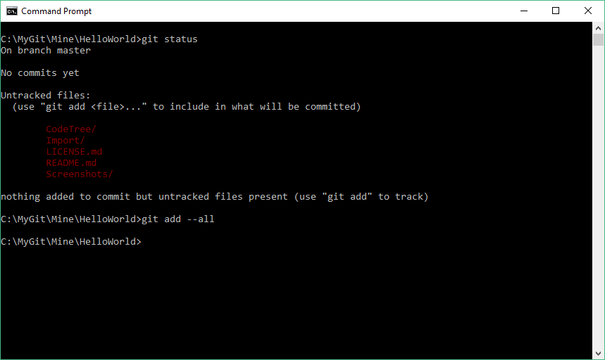

Stage the Changes
Check the repo status, then stage files with the "git add" command
The command prompt window doesn't automatically display which changes are staged/unstaged, so we need to use the git status command to check. Any staged changes will be listed under "Changes to be committed" and unstaged changes will be listed under "untracked files".
C:MyGitMineHelloWorld> git status
To stage changes in a specific file, we use the git add command.
C:MyGitMineHelloWorld> git add MyFile.txt
To stage all changes, we can use git add with the --all flag.
C:MyGitMineHelloWorld> git add --all

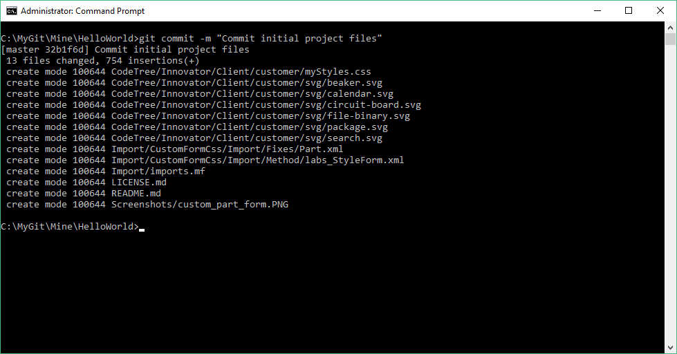

Commit the Changes
Commit staged changes using the "git commit" command
Once our changes are staged, we use the git commit command and include our commit message.
C:MyGitMineHelloWorld> git commit -m "My commit message here"

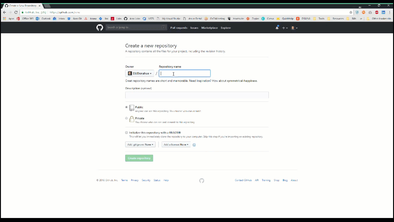

Create Your GitHub Repository
Steps for creating a new GitHub repository
- On your GitHub homepage, click the + icon in the navigation bar and select New Repository.
- In the Repository Name field, enter a short, descriptive name. For our projects, we like to use all lowercase characters and dashes ("-") to replace spaces.
- Enter a brief description in the Description field. This is optional, but it helps users understand the purpose of your project when it appears in search results or in your repository list.
- Keep the default Public setting for your project's visibility. If you select Private, the community won't be able to access your project repository.
- Leave Initialize this repository with a README unchecked if you have already created a README.md file for your project.
- Click the Create Repository button to create the new GitHub repo.

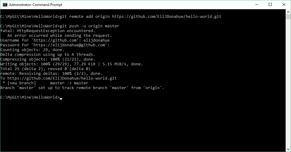

- On your repo's GitHub page, copy the first command from the section titled "...or push an existing repository from the command line".
- Paste the git remote command into your command prompt window. (The current directory should be your local repo.)
C:MyGitMineHelloWorld> git remote add origin https://github.com/EliJDonahue/hello-world.gitPush Project
- In your command prompt window, run the git push command:
C:MyGitMineHelloWorld> git push -u origin master2. Once the command response shows that the push is complete, you can verify by opening the GitHub repo in your browser and refreshing the page. You should see the file contents listed above your README content.
