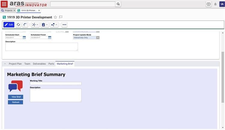

  • Click the green save icon and open up the project, then select the Marketing Brief table

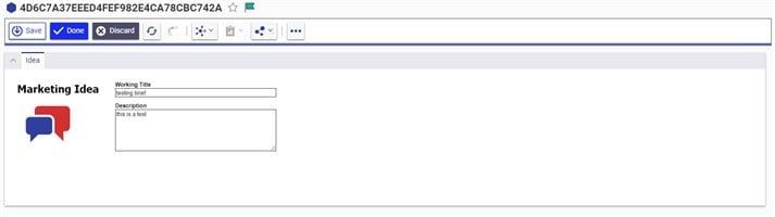

  • Click View brief to add a title and description to the marketing brief form

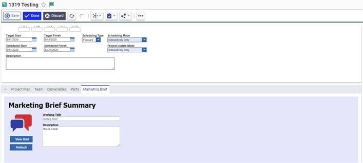

  • After saving and closing the item if you click the Refresh button on the custom form it will display the parameters you have just set
Explanation of Configuration:

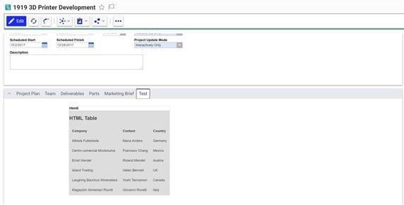

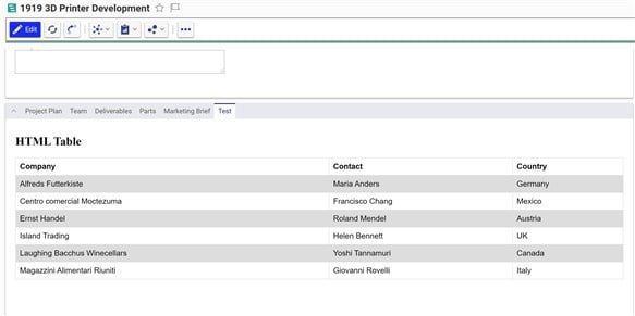

Configuring is as simple as going to the ItemType you want to add your form to and creating a new RelationshipType. In our example the item is called Project Marketing Brief. If you open that item you will see a few relationships. The Relationship View tab contains the identity, and in our example contains a link to the form that renders the html in the Marketing Brief relationship tab. There are a few other parameters here as well, most noteworthy being Start Page. Here you can create custom html that is rendered in the page.
The difference between this and using the Aras Form, like our example, is you can render the html to fit the entire space allotted to the Relationship Tab unlike a form in which the html is contained within a tag. An example of this can be found in the Part MultiLevel BOM RelationshipType which refers to the location of MainPage.html found in the directory of your Innovator Instance > Innovator > Client > Modules > {name of tree grid modules} > Views. Here are some screenshots of these differences:
Through the form
Using "Start Page" property and custom html file
