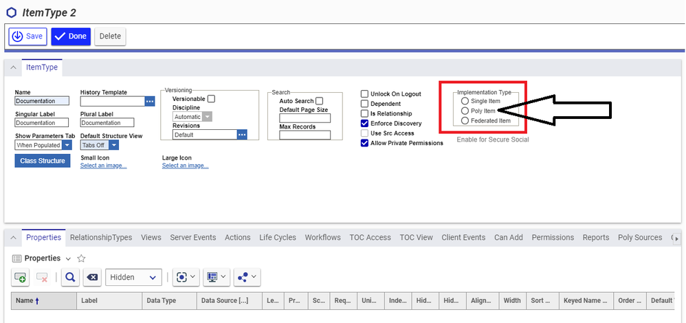

First let’s create the custom Documentation Poly Item ItemType.
  • Go to Administration > ItemTypes > Create New Item Type.
  • Give it the name Documentation.
  • Select Poly Item and hit save. it should look like this:

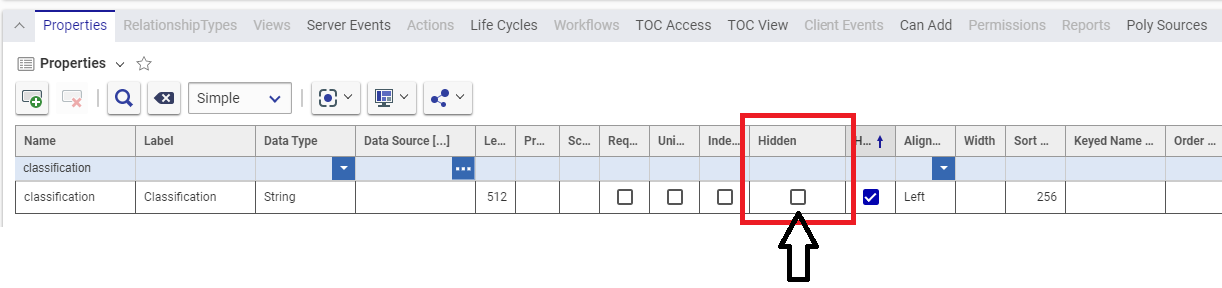

  • Under properties, search classification for the name and un-select the first Hidden attribute. Do the same with the property keyed_name.

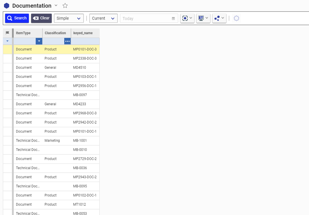

  • Now if we open the TOC and select our Documentation Poly Item ItemType at the bottom, we can search our new ItemType.
After adding these changes, we can see that it is much easier now to search and view all of the documents within our Aras Innovator instance.
