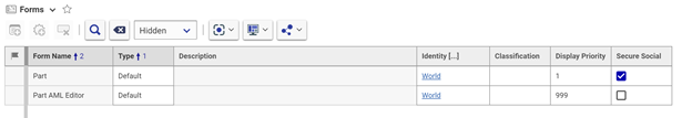

As mentioned previously, there are multiple approaches to packaging modifications to a form. You could edit and package the fields, but that can get overwhelming quick. The method I’ve had the most success with is also quite simple. We’re going to create a copy of the existing form, make our changes to that, and then attach it to the ItemType with a higher display priority. This allows us to export both our form and view, and when we attempt to import it into the new instance, there will be no conflicts.
In our previous blog post [Link] we added an “Example” property on the part ItemType. To ensure people can interact with and provide a value for this property, we’ll add it to the part form!

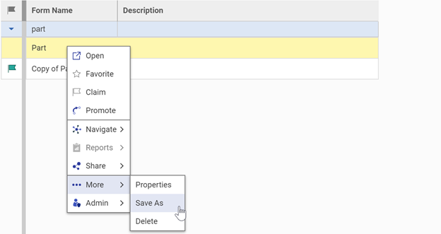

To start this process, we’re going to find our Part Form on the main search grid, and create a copy of it like the image below.
Once we’ve done this, we’ll have an exact copy of our original form we can work with. Now go ahead and make any modifications you’d like to your new form. I’m going to add a box to add a value for the new example property. Once you’ve made your changes, go ahead and attach it to the Part ItemType through the Views relationship.

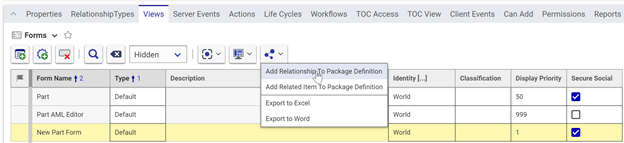

Make sure your new form is attached through the View relationships and has a higher display priority than the default. Once you’ve verified your new form is the default, we’re ready to package! We’re going to be making use of the "CUI Add to Package" Community Project. Since the ItemType already exists in every instance, we’ll end up packaging the relationship between the ItemType and the form, as well as our new form. This will import cleanly on any instance, and always leaves the option to revert the form if necessary. It’s important to note that you need to package the View and the Form. The form can be packaged by right clicking it directly on the main grid and adding to a package. The View needs to be packaged from the relationship tab, using the button shown in the screenshot below.
