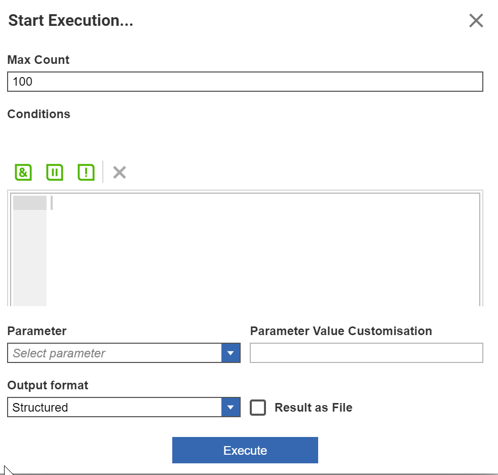

As of SP8 there is a new button which is enabled when attempting to run a Query Definition. Once you’ve checked that button and run your query, the result will be downloaded to the client system immediately.

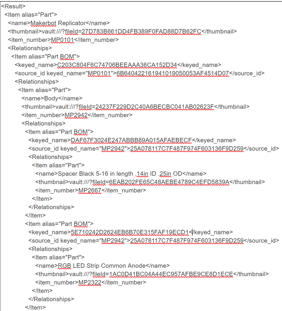

The other options on this dialog allow you to limit the number of results, add parameters, and choose a flat result vs a structured result. Structured gives you more information about the relationships between results, while flat will give you a flat list of all items in the result.Here's an example of structured:

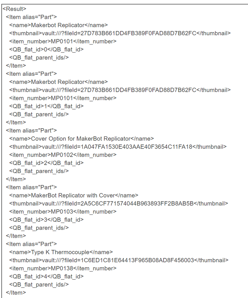

And here's an example of a flat output:
