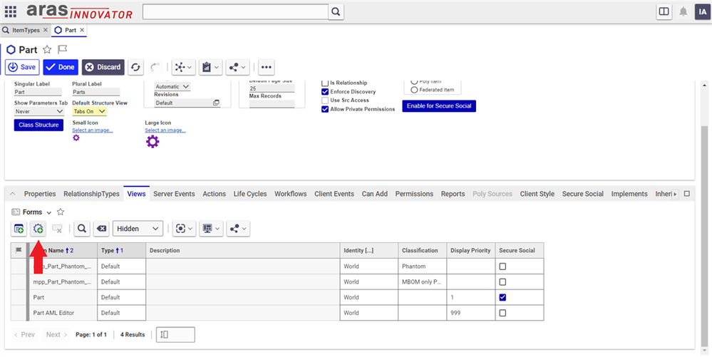

  2. Next click the Edit button and select the Views relationships tab
  3. Add another form by clicking the “New Form” button
  4. In the “Form Name” type in something like "Responsive Form” and set the “Type” to “Default”

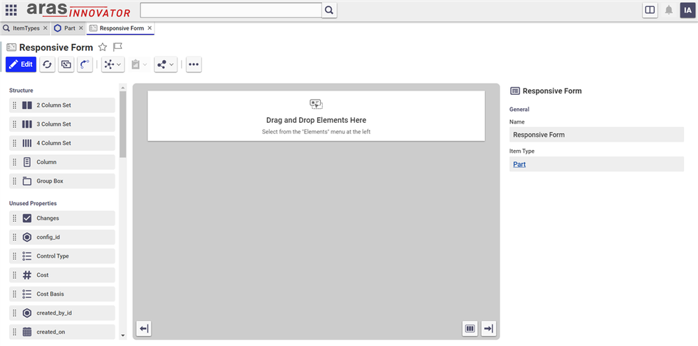

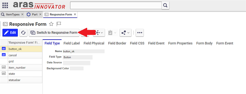

  7. When the form opens you will first see the old editor format; at the top there is a button for “Switch to Responsive Form”. Note when switching to a responsive form, if there was already a previously designed one the responsive switch will not carry over its data

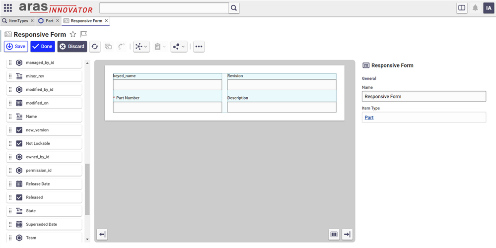

  8. It should look like this after the switch:

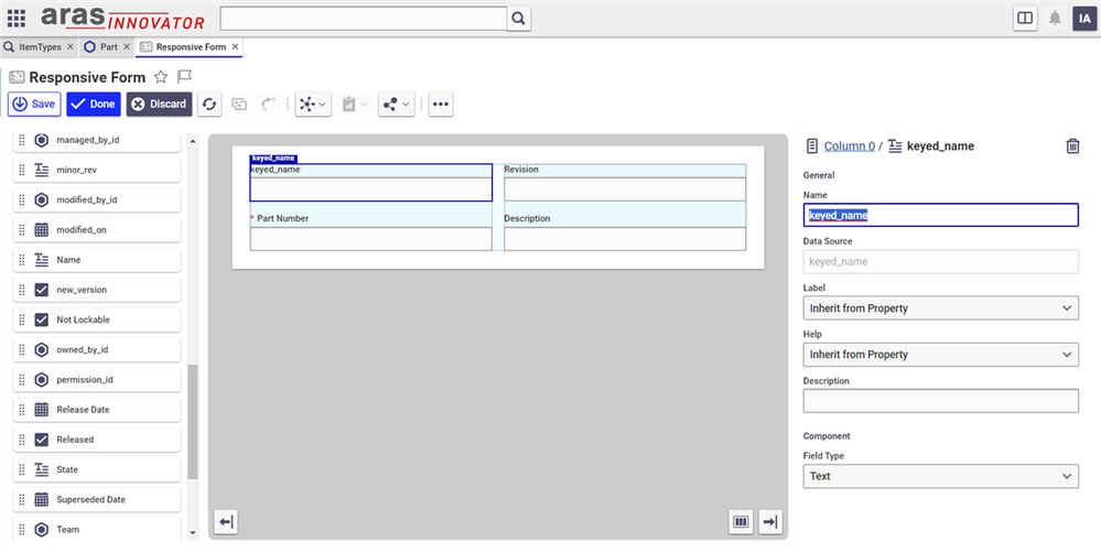

  9. As you can see on the farthest left side of the editor there are two different sets of elements we can select blocks from, Structure and Unused Properties. Structure can be used for formatting elements into columns and boxes. Unused Properties are simply the properties we can include on the form such as part number or description.
  10. For simplicity, let's create a very simple form and add 2 columns with 4 properties. First, click and drag “2 Column Set” into the form, then drag "keyed_name" and "Part Number" into the left column; then drag "Name" and "Description" to the right column. It It should look like this:
  11. If you click on any of the elements dragged into the form you will see more configurations on the right pane as well. Let's click on the "Keyed_Name" property and give it another name, such as simply “Name”

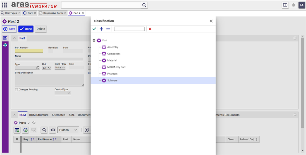

  12. Now let's take a look at the form in action and make sure it looks the way we want it to. Open up the TOC > Design > Click on Parts and then click on "Create New Part"
  13. Initially we will see the old default Part Form, but we can change it to the new form using the classification we set earlier. Click on the Type property and select “Software” from the drop-down:

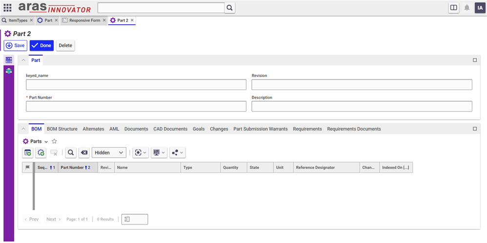

  14. If everything is configured correctly it should look like this:
