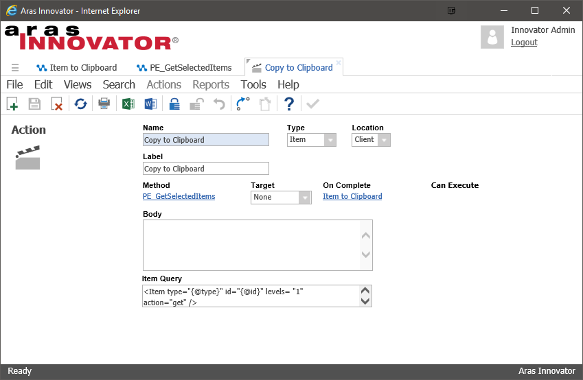

The Copy to Clipboard action requires the following properties to work as a multi-select item action. Other properties (name, label, target, etc.) can be set to fit your use case.
The "method" property must be set to PE_GetSelectedItems in order to pass the collection of selected items to our custom method - Item to Clipboard. Without PE_GetSelectedItems, only the last selected item would be available to our method code.

Creating the Action
- Type: Item
- Location: Client
- Method: PE_GetSelectedItems
- On Complete: Item to Clipboard

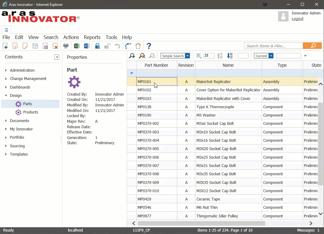

Final Result
Once you attach your Copy to Clipboard action to an ItemType's Action tab, you will be able to select multiple items and copy their data to your clipboard.
