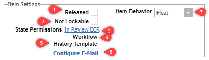

Item State Settings
A life cycle will need a start state, although it does not require an end or released state. Opening a new life cycle map will set the start state to the existing default state. To move the start state flag, right-click on the state you wish to flag and select “Set as Start State” from the menu. Beyond that requirement the following settings are available at the state level:
  1. Released
    • When an item is “Released,” the item will no longer be editable unless it is bumped to a new version. This will also reset the life cycle.
    • Example: An item could be "released" when a change request is completed on the item, resetting the life cycle for the next generation of the item.
  2. Not Lockable
    • States in Aras can also be set to “not lockable” so that no edits can be made while in that state, however this is different from released as the item is not versioned for this lockout.
    • For example, if set for an “In Review” state on a Part item, it would not allow edits in the traditional sense, requiring users to make changes via the change management system.
  3. State-level Permissions
    • Setting a permission at the state level will override the default permissions set on the item.
    • In the above example with the CM lockout, a state-level permission could be applied to only let members of the change management group edit the item in question.
  4. Workflow
    • A state can be set to start a workflow, as opposed to the workflow starting automatically at item creation.
    • The setting could be used to start the item's workflow after it is manually promoted out of an idea holding state and into active engineering.
  5. History Template
    • An item’s history template can also be overridden here. Note: the original item must have a template set for this to occur.
  6. Email
    • A state can be set to send an email, similar to other places in the system; however the syntax is somewhat different as noted in the referenced blog post.
  7. Item Behavior
    • The Item Behavior setting is special. This toggle controls item versioning, if it has been set on the ItemType. It will also need to be set on the relationship, in addition to on the life cycle. There are 4 possible settings:
      • Fixed- The source item (in the current state) points to a specified generation of the related item.
      • Float- The source item (in the current state) points to the latest generation of the related item.
      • Hard Fixed- The behavior is Fixed, as described above, and cannot be changed by any subsequent states in this life cycle.
      • Hard Float - The behavior is Float, as described above, and cannot be changed by any subsequent states in this life cycle.
