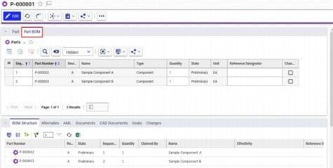

Open up any item. You’ll see the name of the item up top, the command bar beneath that, and then the majority of the actual data held in two “accordion” views. Generally, the first accordion shows the information of the specific item, and the lower accordion shows the relationships that item has. This is a general rule- some items are arranged differently. How? Follow along to see how to move a relationship tab to the top accordion.
We’ll use Parts as our item and the Part BOM relationship as our relationship to move, but this basic process should work on most items and relationships.
Now if you open a Part, you should see the Part BOM tab is showing in the first accordion. This lets you see the Part BOM and relationships at the same time, and makes it easier to find the Part BOM relationship.
Of course, now we have the Part BOM tab in two places- the top accordion and the bottom. While there’s nothing inherently wrong with that, and it may actually be useful if you want to be able to compare a relationship against any other tab, it’s usually not how we do things. What we give, we can take away, like so:
Now it won’t show in any relationship accordions. Since that’s the second set of tabs, when you combine these two procedures you’ll have effectively moved the Part BOM from the bottom to the top. Keep in mind that it hasn’t “moved” really- you made a new one, and hid the old one- but that won’t matter in most cases.

Add a Tab
- Open the Part ItemType.
- Select the Client Style relationship tab.
- Right click the entry in the grid and click Open.
- Click the Edit button.
- Select the cui_PresentConfigWinSection tab.
- Click the New button in the toolbar.
- Set the Classification to Data Model.
- Set the Name to Accordion1.
- Set the Location to ItemView.
- Set the For Identity to World.
- Click the Save button
- Right click the new window section.
- Select Open.
- Click Edit
- Set the Type to Tab Element Control
- Set the Name to ACC1_BOM_Tab
- Set the Label to Part BOM
- Set the Additional Data to {“relTypeId”: “159C6D88795B4A86864420863466F728”}
- Set the Parent to ItemView.FormAccordionTabs
- Set the Sort Order to 1024
- Set the Action to Add
- Click Save.
Hide a Tab
- In the table of contents, navigate to Administration-> RelationshipTypes
- Search for Part BOM and open it.
- Click Edit
- Check the Hide In All box.
- Click Save
