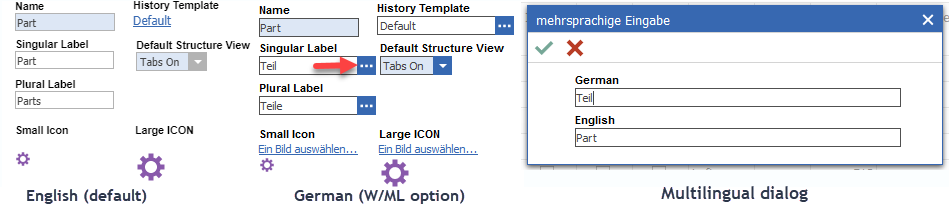

With all of the above settings finalized, the properties that can be configured as multilingual will have a selection box next to them. You can click this box to access the multilingual interface, which will allow you to input a value for each language. This will also work in search grids.
