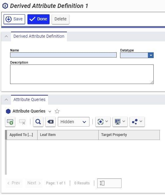

Derived Attribute Definitions meanwhile allow queries to be run against all manner of other items and properties and are found in the table of contents just above Environment Attributes. Perhaps we only want most users to see parts which have up-to-date documentation and to hide documentation which is not current.
The name and description are common sights in Aras Innovator, and the Datatype simply refers to the kind of data that your query should return. The novel bit is the query itself, which goes in the Attribute Queries pane below. Each query has three parts. First, the Applied To column selects the item type which the query starts with. The Leaf Item is where you can use the related items and relationships from the root to specify the item type the query looks towards. The last part is the target property you want your query to return! For details and tips on building queries, take a look at this blog post on the subject.

  1. Name your Derived Attribute. In this example, we'll name it "isDocumentCurrent"
  2. Double click the Applied To column to open up an ItemType selector.
  3. Search for and select Part.

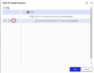

  4. Double click the Leaf Item column to open up the query builder.
  5. Right click the root node ("Part") and, under the "Add Related Item" option, click "Using Relationship"
  6. In the resultant menu, click on Document
  7. Click Add. You should now see the Part Document relationship and the related document.
  8. To the left of the related document, you can hover over several options. (See below!)
  9. The rightmost option allows you to add properties you wish to use. Click that.
  10. Select the "modified on" property from the drop down, then click save.
  11. Below, click OK.
  12. Now you should be back at the Derived Attribute screen. Save the attribute using the save button at the top.
