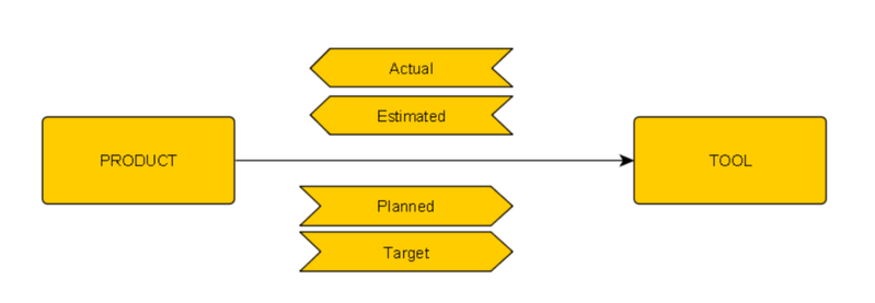

For step 1, I did the following :
  • I created two project templates.
  • The Tool project acts as a child project for Product. It has a property "parentProject" to make the link.
  • Before updating any project, the connected project will be updated.
  • This is a two-way synchronization but not on the same date properties.
  • The link between parent-child activities is done on fixed activity name matching.

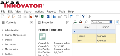

Here are the two project templates:

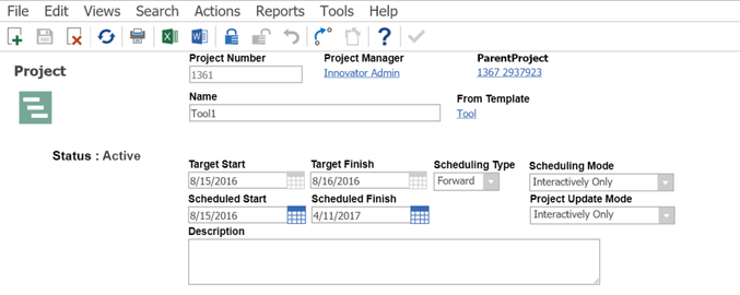

A Tool project has a Parent Project with which it will be synced:

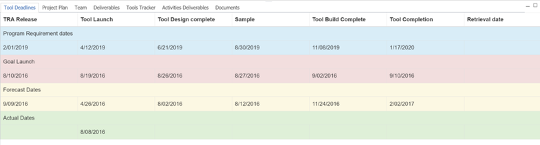

In the Tool window there is a custom table to show all the constraining dates, coming either from the Tool project or the Product project.

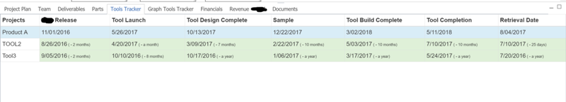

In the Product project we have a custom table reporting all the dates on specific shared dates.
