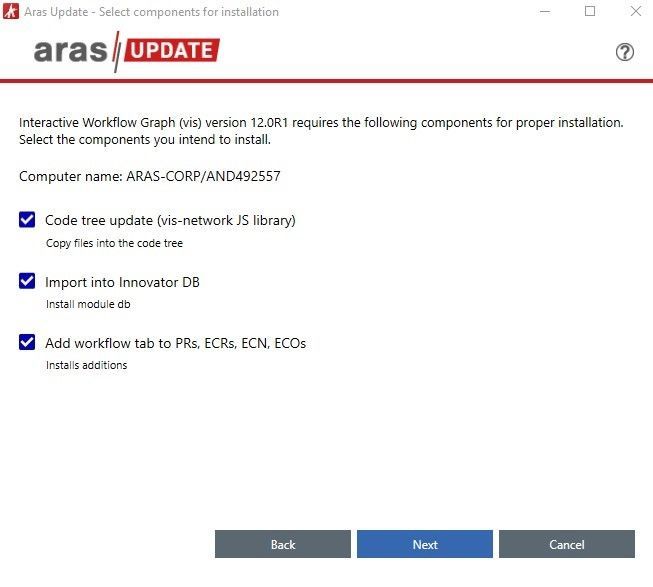

  6. Review the install selection. Click on "Next"

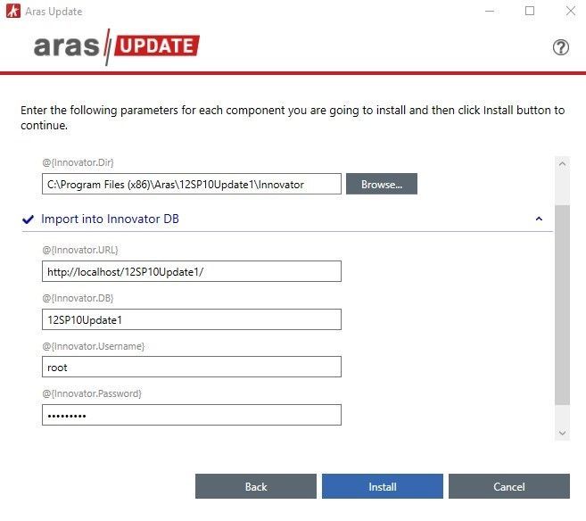

  2. Click on "Browse" and select your Aras installation folder (choose folder "Innovator")
  1. Click on "Import into Innovator DB" and enter your connect parameters for Innovator URL, Database, Innovator user (admin), and the User Password
  2. Click "Install" - wait until success message appears

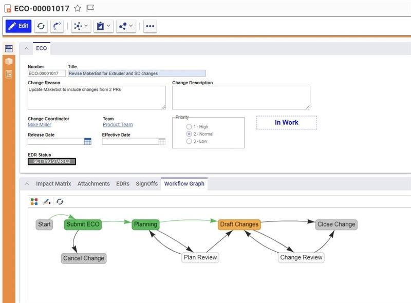

Open up an item you've got a workflow for. In our example today, we'll use ECOs, but this project is fully capable of working with ECRs, ECNs, and even PRs. In your relationships, you should see a tab for the Workflow Graph. Click it- for the moment, we'll assume you've already set up a workflow for this ItemType in the past. And that you like the Irish flag!

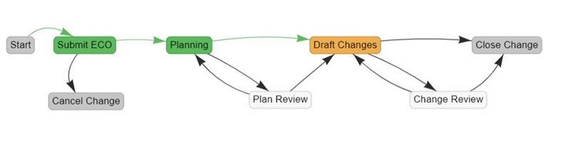

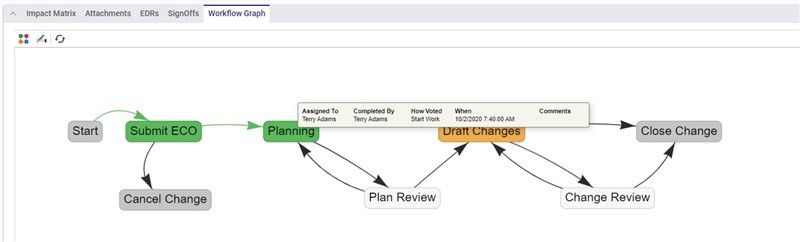

Not only can you see your Workflow, but there are some quick ways for you to get the information you need, all without leaving this page. Green means it's already complete, orange is the active step, and your grey and white indicate stages you haven't gone through yet. Mouse over one of your stages, and you'll be presented with a quick summary of what's going on with that stage, such as who it's assigned to and if there were any comments. Left click anywhere on the graph and hold the click, and you can drag the Workflow around to better see some part of a complicated web of connections. Your mouse scroll wheel will zoom in and out, again a useful trick in more convoluted Workflows.
Lastly, there are two more features of this project that deserve your attention. See those icons just above the Workflow Graph? A circle of arrows, a hand with a pen, and four colored squares have some shortcuts. The circle will refresh the Workflow. The pen, on the other hand, will show you the process history for that Workflow. Meanwhile, you may have recognized the four colored squares as the symbol we use for Workflows in the first place! That will open up the form for the workflow, where if you have permissions you're only a click away from editing and changing the flow. Now that is a setup worthy of the rapid, iterative processes you need in today's world!
