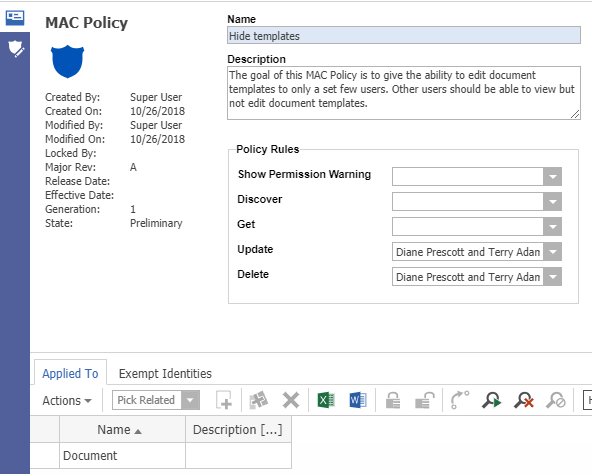

A MAC Policy has a few different parts which all work together to help define the policy. The image below is the main form for MAC Policies.
Let's start with the two relationships on MAC Policies. Applied To is where we can define the ItemTypes which will be affected by this MAC Policy. There are some restrictions on what kind of items can utilize MAC Policies, but the majority of standard ItemTypes are valid. Once you apply a MAC Policy to an ItemType, any interactions with that item will trigger an evaluation of the policy definition. The only exception to this, is if the user is a member of an Exempt Identity. Any identities added to that list will have standard access to whichever ItemType this MAC Policy is applied to.
The Policy Rules relate to the standard Innovator access levels. Here you can assign different levels of access control to different permissions. This means you can define one policy for get permission, and a completely separate set of permissions for update. Each permission can be assigned a condition, which is specified within the MAC Policy editor. You can navigate to that using the ribbon on the left.

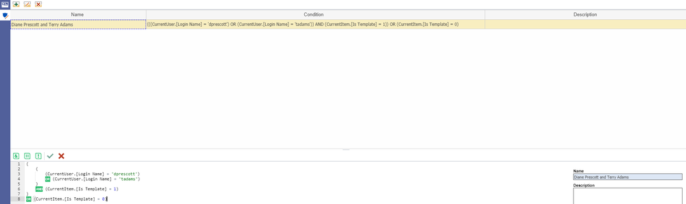

Defining the Condition
Conditions are the heart of a MAC Policy. This is where you actually create the logic which is checked when a user interacts with an Item.  The condition is evaluated, and if a value of true is returned access is granted, otherwise it is denied. There are a few things you should note about MAC conditions:

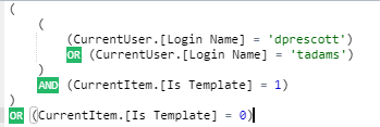

The condition above limits access to template items to the specified users. The OR  statement is necessary to ensure that access to standard project items is not affected by the policy. The ability to utilize a collection of Boolean operators allows for you to write complex conditions to control access. Here is another example of a simple MAC condition.

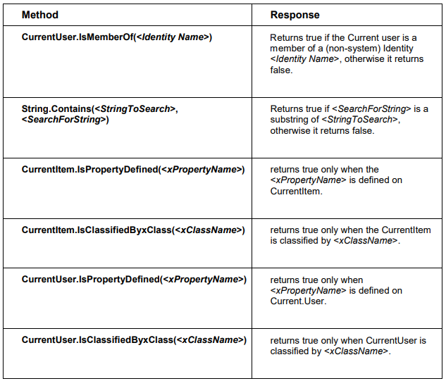

The example above allows anyone to access different parts, but only members of the All Employees identity can access parts classified as software. This condition utilizes one of the unique functions available within MAC conditions. IsMemberOf() is a function which is evaluated when the policy is, checks to see if the active user is a member of the specified identity. Here is a list of functions you can utilize in your MAC conditions.
