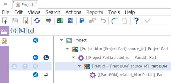

The Query Definition below will select all of the parts related to a project plan, including parts related through the BOM.

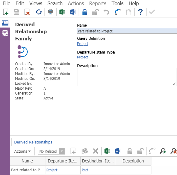

The DR Family Definition maps DR Family elements and non-root Query Items contained in the Query Definition, which are in turn used to create DAC Subdomain Policies. Below is an example of a DR Family which utilizes the Query Definition above.

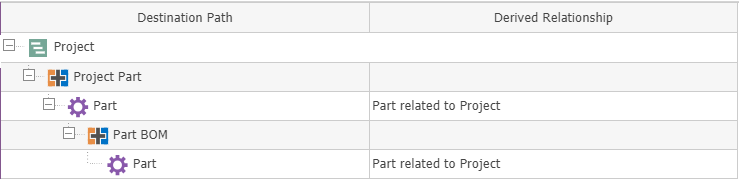

You can add a Derived Relationship to the item, and set the Destination Item to Part. Once you've configured your DR Family like the one above, navigate to the editor on the left. Here you will see a consolidated view of your Query Definition you defined earlier. You'll want to set your newly created Derived Relationship on each Part item within the Query Definition. It should look like the screenshot below.

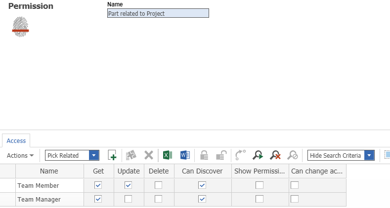

The final step before we configure our Policy is configuring permissions for our DAC Subdomain. We'll be creating a permission which grants different rights to different roles within a team. It can be configured like the screenshot below.

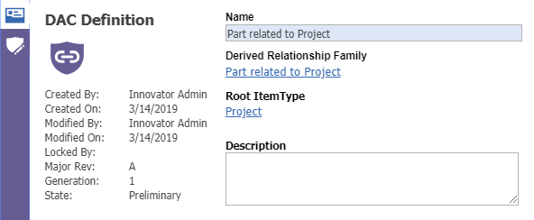

To create a DAC Policy you can navigate to Administration > Access Control > DAC Definition. On the main form, we can set then name, root ItemType, and DR Family. It should look like the picture below.
Using the definition editor, which can be accessed using the ribbon on the left, we'll be setting the proper permissions for our policy. We'll set the Subdomain Permission to our recently created permission, and set the Root Permission to the default Project permission. In this example, the Destination Life Cycle State is left empty to grant subdomain permissions to parts that have any Life Cycle state. If the Subdomain Policy should apply to a part in a specific Life Cycle State, click on the ellipses in the Destination Life Cycle State cell and select a Life Cycle State.
Once we've configured it to our liking we can activate the Policy. This can be accomplished by promoting the DAC Definition item to an active state. If your DR Family isn't configured properly you will not be able to promote your DAC Definition.
