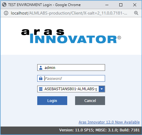

One of the first lines within an InnovatorServerConfig file is the UI-Tailoring tag. This tag allows you to define a few UI elements which can help make your environment stand out. The following attributes can be set within the UI-Tailoring tag:
  • login_splash - The URL (relative to the Innovator home directory) to the image to be used on the Innovator login screen.
  • Branding_img – The URL (relative to the Innovator home directory) to the image to be used in the header.
  • product_name - The title to be used on the main Innovator window title bar
  • banner_url - The URL (relative to the Innovator home directory) to the HTML page to be used as the Innovator banner.
  • banner_height - The height of the banner section of the main Innovator window, if no banner is desired, set this value to 0.
These flags allow you to make your different instances distinct. Having different login_splash images is a great way to ensure that someone knows exactly what they’re logging in to. Branding image and product name are very useful because they’re always visible. Something simple like making sure the product name flag is set properly on each instance can make a big difference for someone quickly going back and forth between multiple instances.

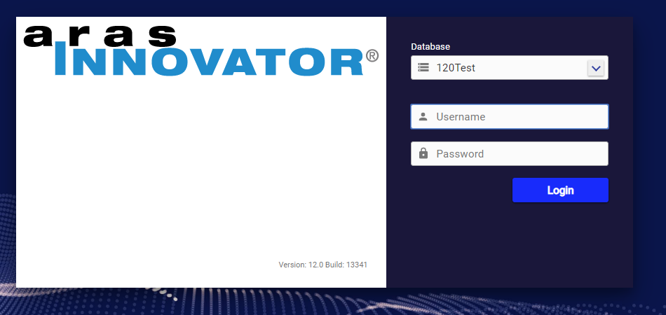

Innovator version 12 has had some architecture changes, and because of that, some of the UI modifications are handled in a different location. The notable exception of this is the product_name portion of UI-Tailoring.  The images used for the login screen have been moved to a new location. They can be found at OAuthServer/wwwroot/images . Here you’ll see arasInnovator.svg, which is the default logo for the login splash.

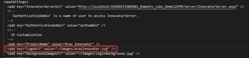

Due to architecture changes we are unable to set path to this location through the UI-Tailoring portion of the InnovatorServerConfig file. To change the image used on the login screen we’ll need to modify OAuthServer.config. There is a key within this config file which is called LogoUrl.
Setting this to any other image which you put in that folder will allow our OAuth server to point to the correct image. To actually see any changes reflected in the environment we will have to reset IIS. Upon your next attempt at logging in you should see your changes. The image below is a good example of a login screen with a modified image. You could put your own branding at this location, or some special image to differentiate between instances.
