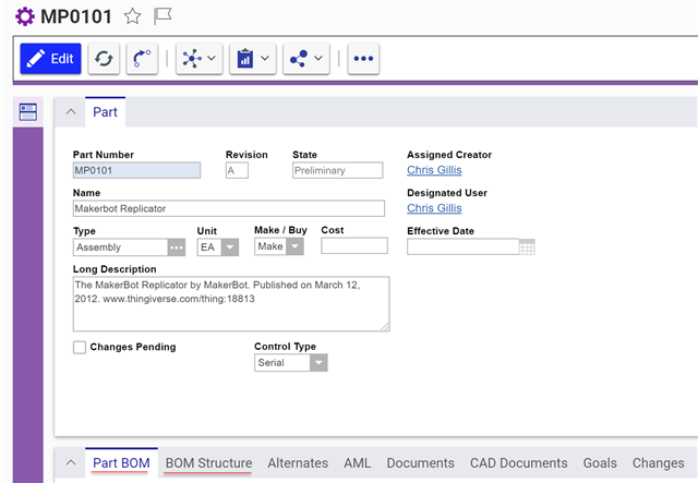

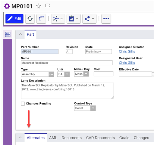

If we go and open a Part now, we can see that the Part BOM and BOM Structure relationship tabs are no longer visible.

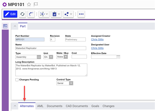

Since we're already signed in as admin, let's open a Part to check if we can see these tabs now.
While we're at it, let's also make sure these tabs are hidden for a user who is not an Administrator. When we log in as this user and open a part, we indeed can no longer see the Part BOM or BOM Structure tabs.

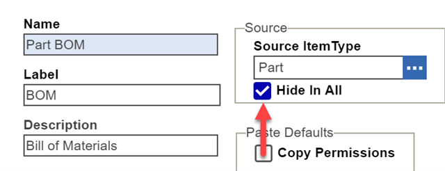

Let's take the first step of hiding the relationship for everyone.
- Log in as admin
- Go to TOC > Administration > RelationshipTypes
- Hide the Part BOM relationship
- Search for and open Part BOM
- Edit this relationship and check the Hide for All flag

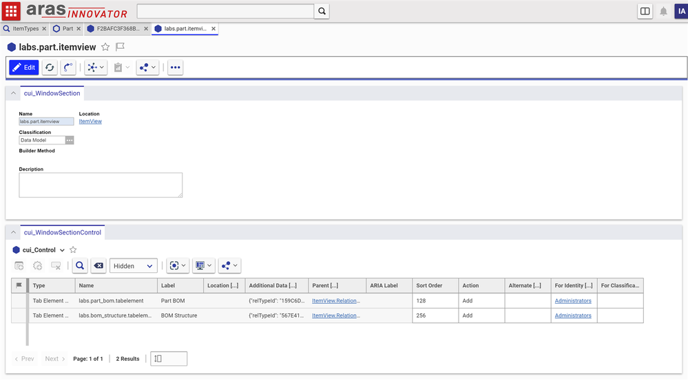

This is currently true for every user, so now let's re-enable these tabs for only our Administrators. To begin with, we'll need to add a CUI section to tell the Part ItemType that it's going to have custom tabs.
- Navigate to TOC > Administration > ItemTypes
- Search for and open the Part ItemType
- Select the Client Style relationship tab and open the item here
- This is the item that controls all of the ItemType-specific CUI for Part
- In this Presentation Configuration, select the cui_PresentConfigWinSection relationship tab
- Create a new related item here to indicate that the Part view will have custom CUI
- Classification - Data Model
- Name - labs.part.itemview
- Location - ItemView
- For Identity - World
- Open this new related item
- In the cui_WindowSectionControl tab, add a new item to represent the Part BOM relationship
- Type - Tab Element Control
- Name - labs.part_bom.tabelement
- Label - Part BOM
- This will be the label on the relationship tab
- Additional Data - {"relTypeId": "159C6D88795B4A86864420863466F728"}
- The ID here should be the same one you copied from the Part BOM RelationshipType earlier
- Parent - ItemView.RelationshipAccordionTabs
- Action - Add
- For Identity - Administrators
- This is the Identity that will be able to see this tab
- Repeat the same steps to add a new item for the BOM Structure relationship
- Name - labs.bom_structure.tabelement
- Label - BOM Structure
- Additional Data - {"relTypeId": "567E4149FBF74DACA0B0C4C9B1E79A3B"}
- This should be the same ID you copied from the Part MultiLevel BOM relationshiptype earlier
- Action - Add
- Save and close this item
- Save and close the Presentation Configuration
After following these steps, it should look similar to the screenshot below.
