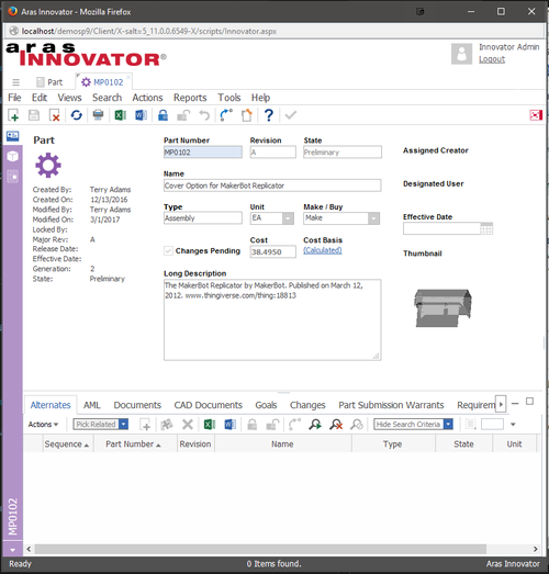

BOM and BOM Substitute tabs hidden in Aras SP9
This project demonstrates how to hide the BOM and BOM Structure tabs on the standard Aras Part form. We add an OnLoad form event to the Part form, which contains the custom JavaScript functions and logic for hiding the specified relationship tabs. In the form event's main function, hideTabs(), we first check to confirm that the relationship grid has been loaded. Once the grid is loaded, we use the form's relTabbar object to explicitly select the Alternates tab and hide the BOM and BOM Substitutes tabs.

To confirm that the form event works, navigate to Design > Parts in the table of contents and open any Part for viewing. The first relationship tab should be the Alternates tab, and the BOM and BOM Substitutes tabs should not appear at all.
