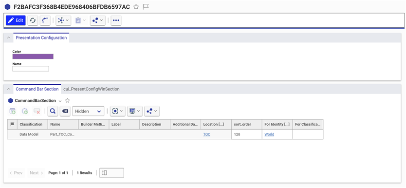

  • Then select and open the Item Presentation Configuration:

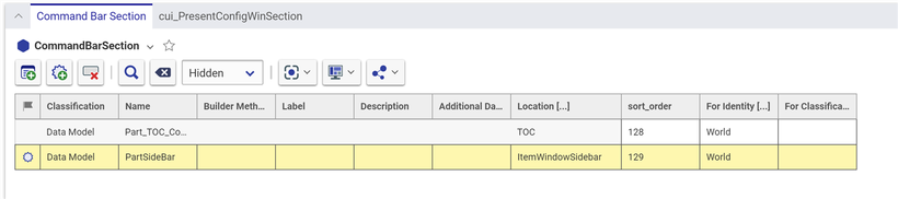

  • Hit the Edit button  and then the add Item button in the Command Bar Section
  • Type in the following:
  • Right click or double click anywhere on the new Item you have created here and select open

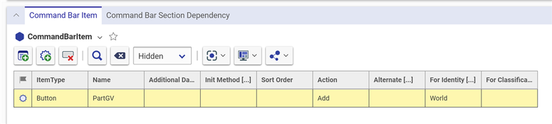

  • Add a new CommandBarItem below and select Button
  • Fill out the following properties:

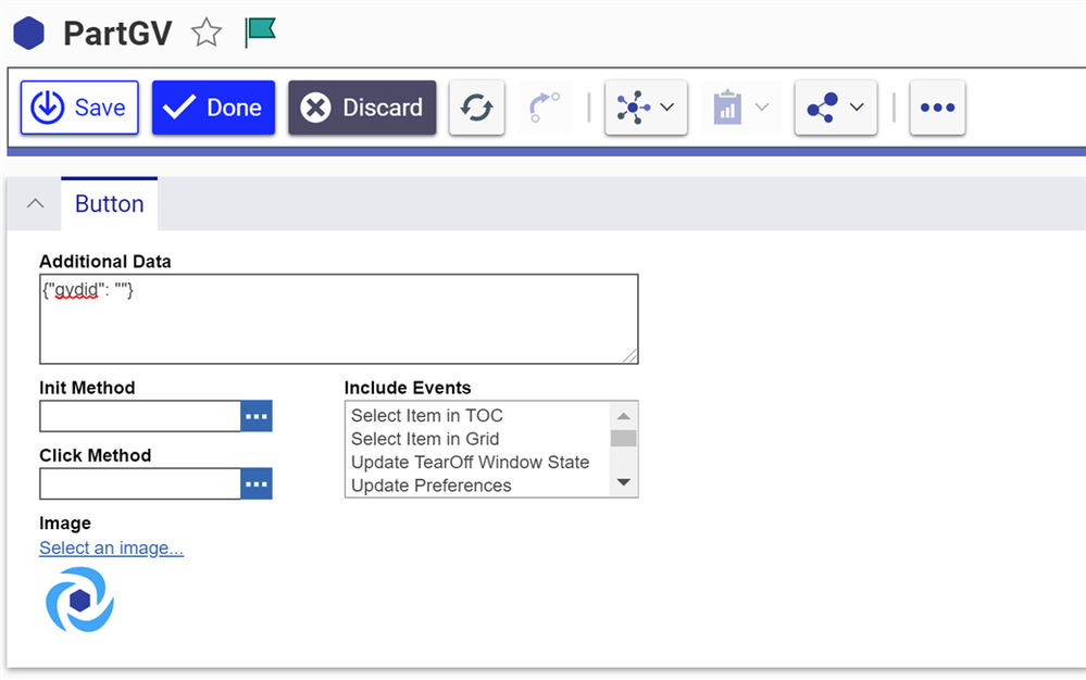

Creating the Sidebar CUI Button
Now we can go ahead and set up our button that will call the action on the correct Graph View Definition:
  • Right click or double click on the newly created CommandBarItem and select open
  • Here we will input the following:

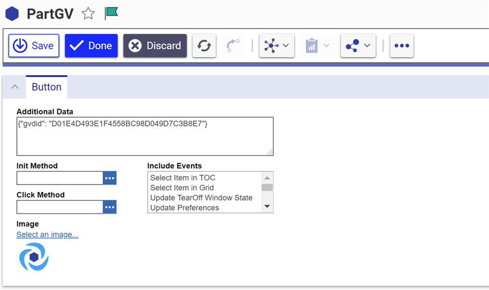

Finally we will need to add in the graph view definition to our side nav button:
  • Open the TOC > Administration > Configuration > Graph Navigation > Graph View Definition > Search Graph View Definition
  • Then search for “Child Parts and Documents” once you open this graph definition click the actions button   and then properties
  • Copy the ID then go back the PartGV. Within the box labeled Additional Data input the following {"gvdid": "D01E4D493E1F4558BC98D049D7C3B8E7"}
  • Now for our click method we will go back to the TOC > Administration > Methods > Create New Method and input the following (don’t forget to name your method!):
gist.github.com/.../afda493d2a621401c8114f9edbb461f4
  • Go back to PartGV and add the newly created method to Click Method and hit Done

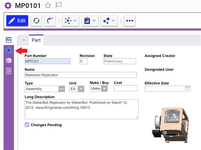

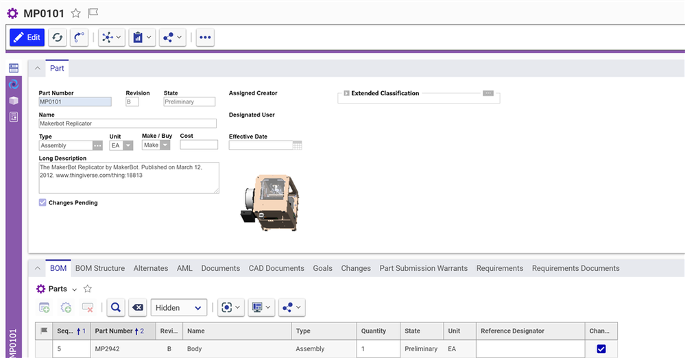

You can test this out by going to the TOC > Design > Parts and opening any part up. The result should look like this with the newly created button on the side nav:
Clicking your new button will open the graph navigation on a new tab!
