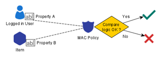

  • MAC policy basically compare properties from the logged in User and an Item:

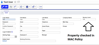

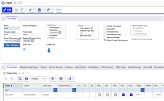

New property on User
Add a new Property:
  • Name = sec_level
  • Label = Secrecy Level
  • Data type = Integer

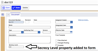

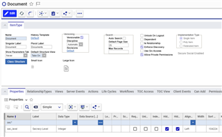

New property on Document
Add a new Property:
  • Name = sec_level

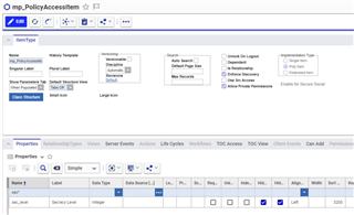

Allow custom property to be used on MAC Policy
We need to modify the ItemType: mp_PolicyAccessItem by adding the EXACT same property as the one just added on the ItemType: Document.
Add a new Property:
  • Name = sec_level

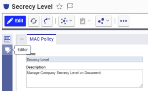

Create a MAC Policy
As an Administrators, go into the TOC -> Administration -> Access Control
And then click "MAC Policies" / Create new
  • 1. Enter a Name (can have some space), and a Description if needed
  • 2. Into the TAB "Applied To", add the ItemTypes you want to activate this MAC Policy (in our case, Document)
  • 3. Into TAB "Exempt Identities" we can add Identities (User / Group of Users) that would skip this rule
  • 4. Save

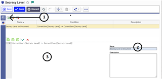

Then we go into the Policy Rule Editor
  • 1. Click into the bar on the "New Condition" icon (first from the left)
  • 2. Set a Name on the bottom right
  • 3. Create the Rule by directly starting to type on the bottom left
    • CurrentUser.[Secrecy Level] >= CurrentItem.[Secrecy Level]
  • 4. Save the MAC Policy

Once you have everything setup, you need to modify your Forms (User + Document) to set the values.
And when a User will need to create a Document or modify one, the Secrecy Level will appear.
Here you can add any Business logic on the Client / Server side in order to avoid people creating documents on a Level that is above their own, or any other business logic.
The result will be, any Document created with a Secrecy Level superior to the User's one, won't be accessible by the user.
