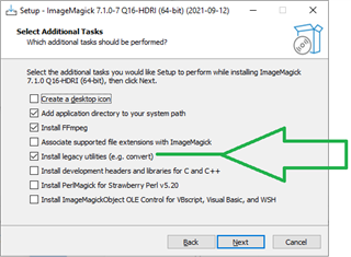

Free tools installation
InkScape: Simply press next.
ImageMagic: For the installation, the only trick is to tick a box to deploy the utilities that we will use

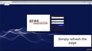

Login screen:
To change the login screen, you need to manually edit a configuration file.
.OAuthServerOAuthServer.config
Around lines 20 (content of this file can differs between version) update the path to your splash and background picture.
<add key="ProductName" value="Aras Innovator"></add>
<add key="LocalAuthenticationDisplayName" value="Aras Innovator"></add>
<add key="LogoUrl" value="~/images/arasInnovator.svg"></add>
<add key="BackgroundImageUrl" value="~/images/loginBackground.jpg"></add>
You can also rename the title that will appear in your internet browser by changing the value of ProductName and LocalAuthenticationDisplayName.

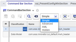

Innovator banner logo:
  1. Login as admin / root
  2. In TOC, go in Administration / Configuration / Client Presentation
  3. Search without entering any criteria, only one result will appear
  4. Open the "Global" and then click on the "Global" link under "Presentation"
  5. Into the TAB Command Bar Section, change the Search from Hidden to "Simple"
  6. Enter the search critera in column "Name": com.aras.innovator.cui_default.mwh_header
  7. Search and open the only result
  8. Once com.aras.innovator.cui_default.mwh_header form is opened, in TAB "Command Bar Item" change the Search from Hidden to "Simple"
  9. Enter the search critera in column "Name": com.aras.innovator.cui_default.mwh_header_logo
  10. Search and open the only result
  11. Edit the Item and scroll down into the form to change the "Image" and select the one you prefer
