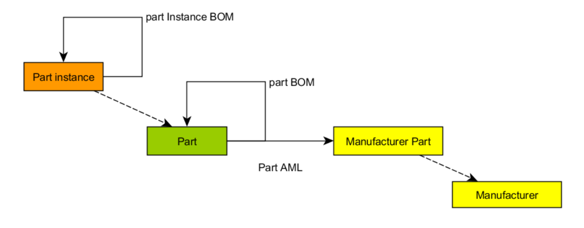

The Use Case
- We start from an physical BOM (read the previous article to understand how this is done).
- On a physical Part, I want to be able to order a replacement Part, so I want an action "Order replacement".
- Once selected, it should open a popup with the potential part supplier references defined in the engineering BOM.
- Once selected, if the supplier already has an open order, it adds the reference to the open order. If not it will create a new order and add the reference.
