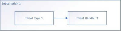

Here is an example of a single Subscription with an Event Type and Event Handler:

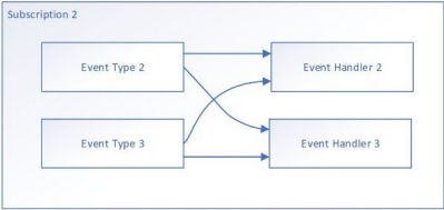

Here is another example of a Subscription with multiple Event Types and Event Handlers. In our diagram below, Subscription 2 contains 2 Event Types and Event Handlers. Each event from Event Type 2 and/or 3 will be processed by both Event Handlers 2 and 3. The same Event Type and Event Handler can also be a part of multiple Subscriptions as well!

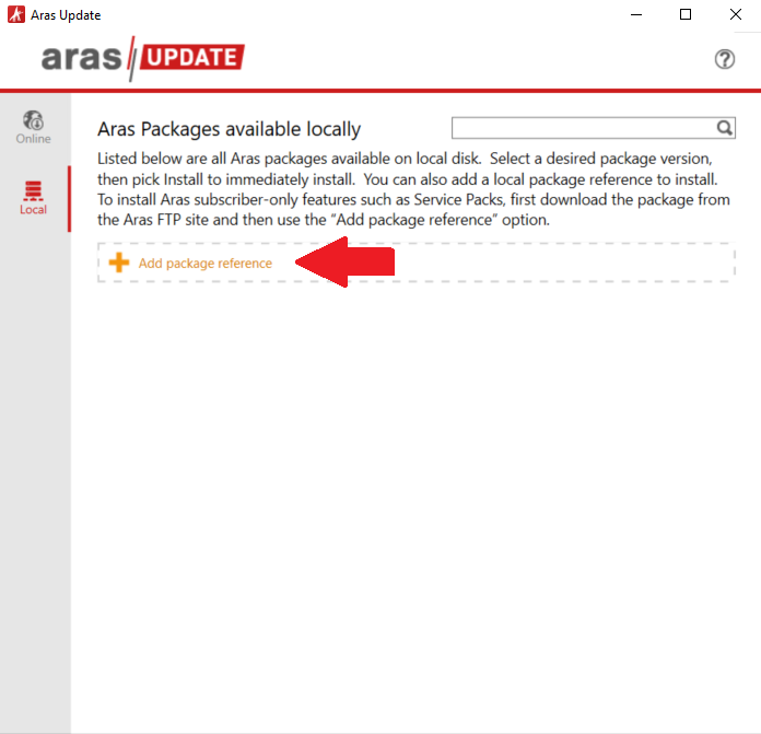

  2. Within Aras Update select local and then click “Add package reference”

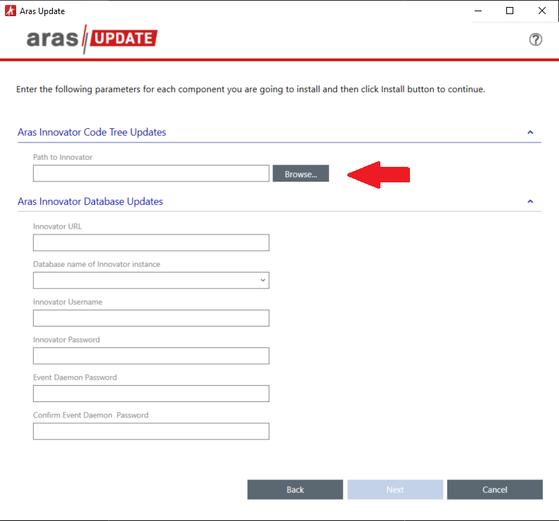

  3. Click through the following prompts for logging until you get to the section asking for the directory of your Aras Innovator instance
  4. Here you will need to fill out the database information and path to Aras Innovator CodeTree
  5. Note that you will need to point it to the Innovator folder in your CodeTree, e.g. the default path for CodeTree installation would be something like: C:Program Files (x86)ArasInnovator

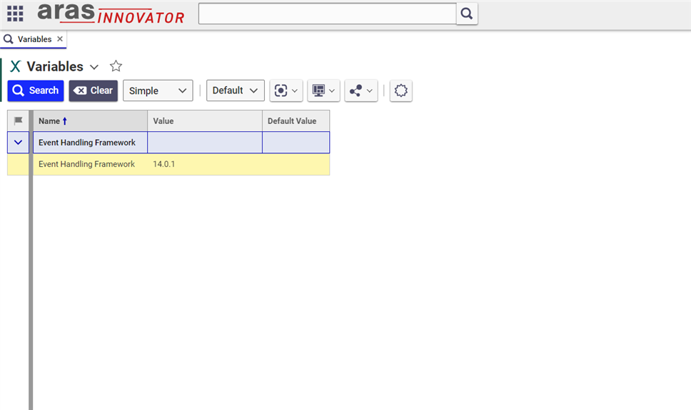

You can then log into your instance of Aras Innovator and utilize the new functionality. In order to verify the application is installed, all you need to do is open up the TOC > Administration > Variables and search for Event Handling Framework in the name column:
