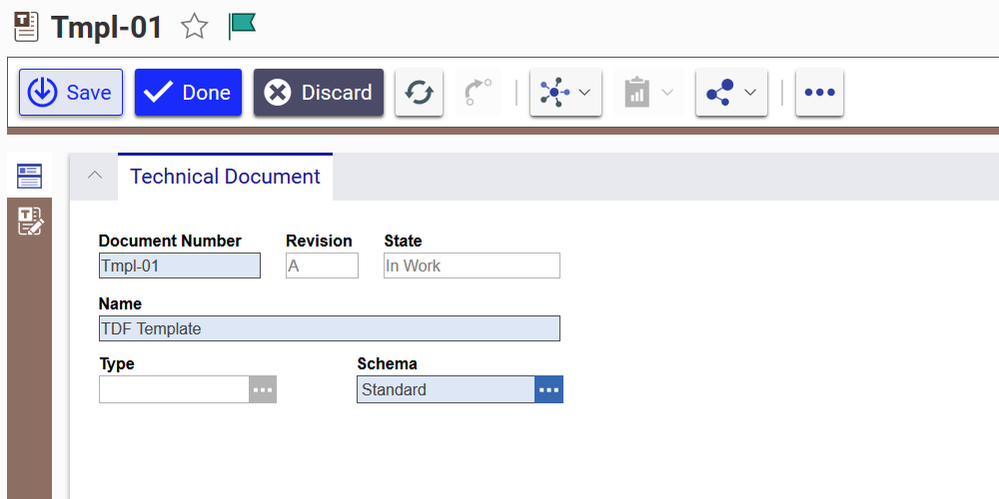

  2. Right click and select Create New Technical Document
  3. Fill out the form’s required information:
    1. Document Number – ‘Tmpl-01’
    2. Name – ‘TDF Template’
    3. Schema – Standard
  4. Save (but don’t close) the new Tech Doc

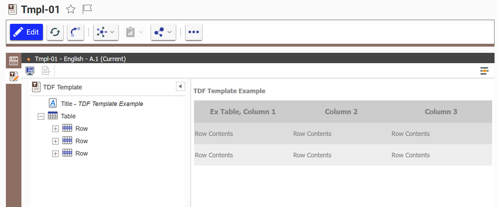

For now, let’s keep this template and explanation simple and just add a title and a table.
  1. In the Document Tree column on the left side, right click on the area labeled TDF Template (the root element)
  2. Click Insert > Title then type to fill the yellow region that is added to the editor to the right
  3. Right click on the Title element in the document tree and select Add > Table
    1. In the resulting dialog, set both to the row and column attributes to 3 then click OK
    2. Confirm that the table is added to the editor area and to the left column as a collapsible tree with three child rows, each with three child entries
  4. Click on the first column and row in the table and start typing in the first header box, then click to the next column or tab through to fill out the table
  5. Click Save and Close and to finish the template

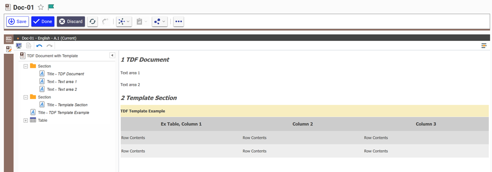

  7. Add a title to the second section, then right click on the section element in the document tree and click Add > From Template
  8. In the item selection dialog, search for the template document, select it, and click OK
  9. Save and Close the Tech Doc
There are a few things to note. For a template to be added to a Tech Doc, both must use the same the schema. Additionally, adding elements "From Template" differs from adding "External Content".  With external content, the elements of the source and target documents are identical and cannot be changed independently.  When adding from a template, the elements are inserted as a copy, so the source and target documents can be modified without affecting the other
Here’s what the final result should look like:
