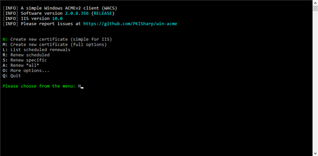

  3. Run the executable in this package
  4. Confirm that you see a command prompt asking what kind of certificate you want to install
  5. Type in 'N' and press enter to create a new certificate

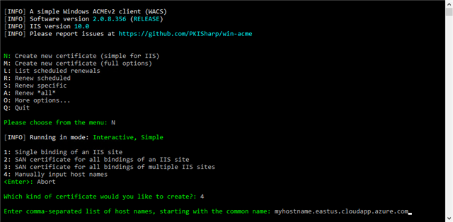

  6. Type in '4' and press enter to apply the certificate against a specific host name
  7. Type in the publicly available host name of your dev box

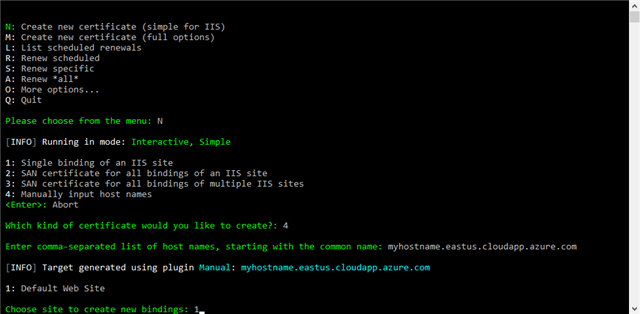

  8. Type '1' and press enter to set up the certificate against the Default Web Site of IIS

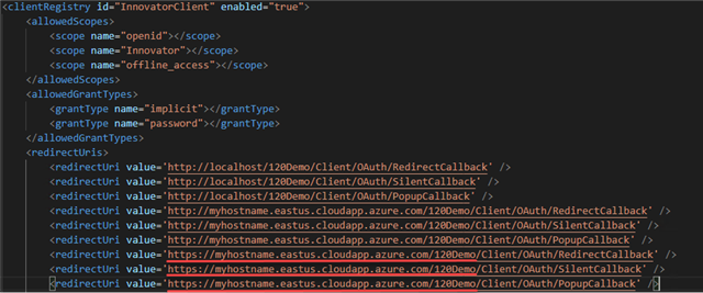

If you are using Aras Innovator 12.0, there are a list of hard-coded URLs in the install folder that you'll need to update to include HTTPS. By default, the install folder would be C:/Program Files (x86)/Aras/Innovator/. From here, the URLs you'll need to change can be found at /OAuthServer/OAuth.config. These will be contained in the <redirectUris/> tag in the InnovatorClient client registry.

  • AppServerURL in VaultServerConfig.xml
    • <AppServerURL/>
  • SelfServiceReportConfig.xml
    • inn_server_url in <appSettings/>
  • OAuthServer/OAuthServer.config
    • innovatorServerUrl in <appSettings/>
  • InnovatorServerConfig.xml
    • InnovatorToServiceAddresss in <AgentService/>
    • Url in <OAuthServerDiscovery/>
  • ConversionServerConfig.xml
    • url in <InnovatorServer/>
  • AgentService/Aras.Server.Agent.Service.exe.config
    • InnovatorServer in <appSettings/>
    • baseAddress in <baseAddresses/>
  • Any other hard-coded urls in the database or code tree. Ex: a custom, hard-coded Vault Server URL
