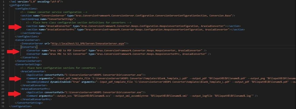

1. Open up the ConversionServerConfig.xml located in the codetree of the installed instance
2. Within the ArasCadConverter input the following tags. Note that within the arguments the input_pdf_template_file needs to be changed to match the correct location of your Blank_Template_L.pdf location within the Hoops Converter:
gist.github.com/.../0b17f52913aab21d185b7d6ea4811944
3. Your full ConversionServerConfig.xml should look like this now:

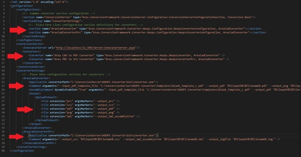

1. Your full ConversionServerConfig.xml should look like this:

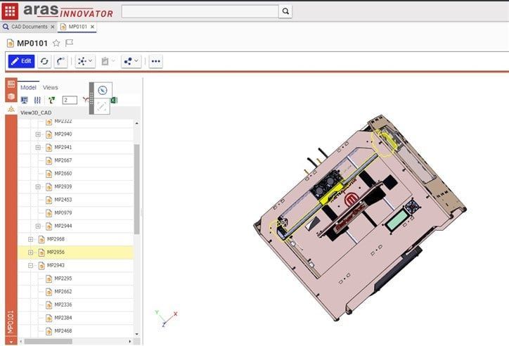

Now that you have successfully configured your instance we can test out those legacy CAD items. Open up Aras Innovator and log in as admin. Right click on any of your legacy items that are assemblies and select the “Dynamically Enable Legacy CAD Items” action  (depending on the service pack you might need to click “more” first then the action to run it). Once the conversion task completes you can open up your item and click on the side navigation DPN button to run the query and view your parts in real time!
The result should build a view as shown here:
Please note that if nothing loads initially you may need to click the refresh button on the side navigation for the view to show. Comment below on what your organization uses DPN for and how this visualization meets your business needs!
