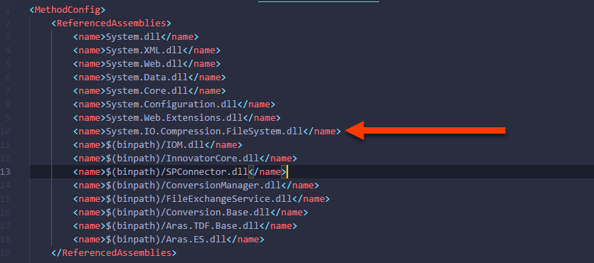

If you try to compile this code as is, you'll receive an error indicating that the ZipFile namespace we're trying to use does not exist. In order to resolve this error, we'll need to add the System.IO.Compression.FileSystem.dll to the InnovatorServermethod-config.xml file as seen below.

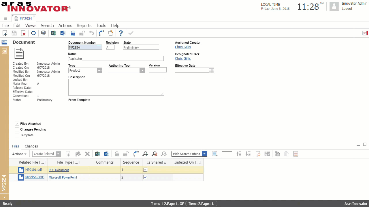

You can see an example of the action being run below.
