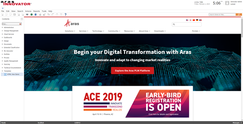

The first method we'll cover is how to display an HTML file when the user selects an item in the TOC. This method of displaying HTML is actually built right into the Aras Innovator client and doesn't require any additional coding beyond what's already included in the HTML file.
We'll start by creating a new ItemType that will serve as the hub from which this HTML file will be called. For demonstration purposes, we'll name this ItemType HTML View. Once we've created this ItemType we'll navigate to the TOC View relationship tab and add a relationship to an Identity who will be able to see this custom view instead of the standard grid. You can even define different views for different Identities! Once we've created the new TOC View relationship, we'll set the Start Page to the relative path of our HTML file in the code tree. You should define this relative path in relation to the /Innovator/Client/scripts/ folder. For example, if your HTML file were in the /Innovator/Client/customer/ folder, your relative path would be ../customer/test.html.
One thing to note is that this Start Page property just needs to point to an HTML source, so you can even pass in the URL to a website. To try this out, let's pass in the Aras website as our Start Page and see what happens.
Note that this may not work for every website.

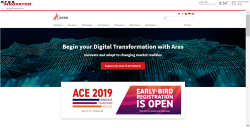

From a New Tab
The last approach we'll go over is how to display HTML in a new tab within the Aras Innovator client. You can do this with code similar to the sample below.
gist.github.com/.../cadbcb2624f8888699a6506483d20e1d
Please note that if you choose to use your own HTML page, you should use CSS to set a background color for the page. While writing the sample above, I did this using the bgcolor attribute on the body tag like so: <body bgcolor="#FFF">. If you don't do this, you'll notice that your HTML page appears to be drawn over the main grid.
Just like with the TOC, we can even pass in websites to be displayed within a tab!
