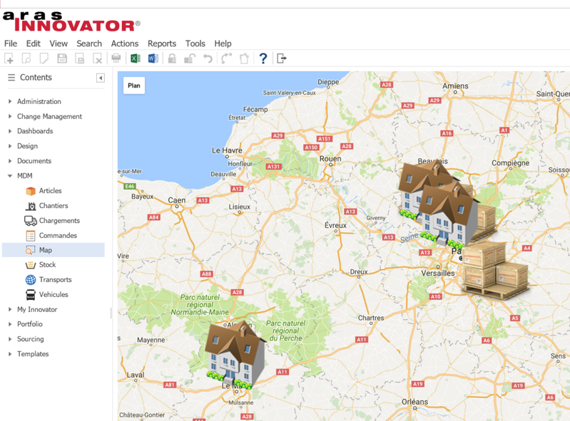

This may sound far from the PLM solution you would imagine but I actually had this requirements a few times during selection process. I believe this was more to have some sexy views for the users but there is one customer where it was a clear requirement answering a business need to be able to select a list of items based on geo space selection.
Use Cases
  • Maintenance for Roads and Electricity Installations where sometimes maintenance & repair operation are based on geographical positions and relationships.
  • Field operation require sometimes the closest suppliers to be identified
  • Dashboard with regional KPIs
Result
Setup Steps
  1. Create an html page and paste the script provided in this article
  2. Save the HTML page in your install folder (ex : c:/program files/Aras/Innovator/Innovator/client/scripts/MAP/map.html)
  3. Create an itemtype ( ex: Map)
  4. Set the TOC access
  5. Set the Toc View to target the HTML page you have created ( "./" = "scripts/" so for the example => "MAP/map.html")
  6. Adapt the itemtype(s) you want to list with lattitude and longitude properties
  7. Adapt the script to call these itemtypes
  8. Go !
