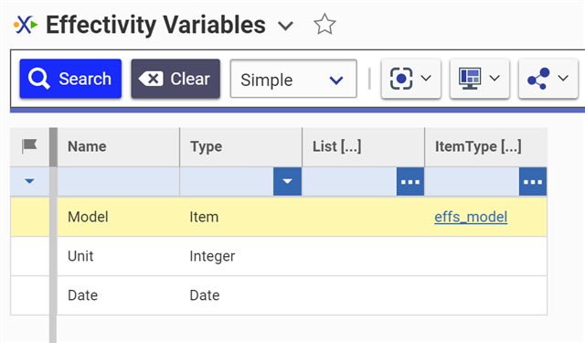

Defining the Effectivity Variables
Before we create the scope, we first need to figure our what sorts of information should be contained in our manufacturing scope. For simplicity, we'll keep this to a manufacturing date, a batch number, and a manufacturing location. Let's start by opening up the Effectivity Variables and checking the existing variables.
- Log in as admin
- Navigate to TOC > Administration > Effectivity Services > Effectivity Variables
- Run an empty search to see all the existing variables
Manufacturing Date
We want our scope to be able to resolve based on when a particular batch of parts was manufactured. By following the steps above, we should see that there's already an existing Date variable. This seems generic enough that we can re-use it for our manufacturing date. Unfortunately, there don't seem to be existing variables for our other two pieces of information, so we'll have to create new two new Effectivity Variables.

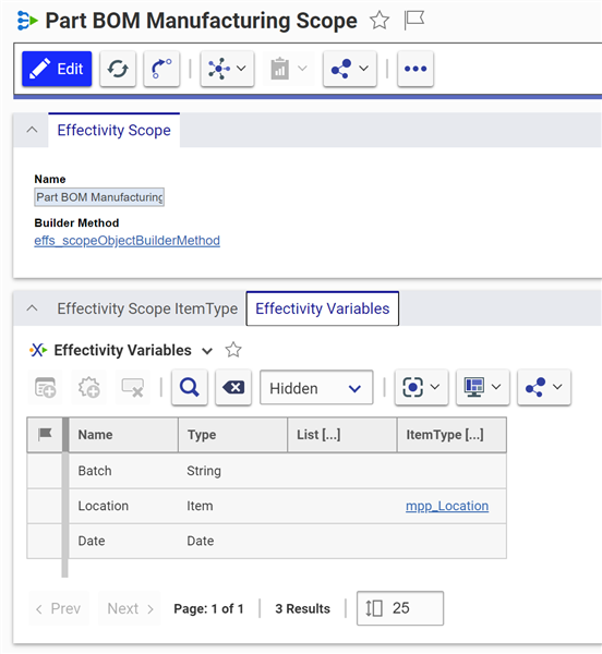

- Navigate to TOC > Administration > Effectivity Services > Effectivity Scope
- Create a new Effectivity Scope
- Name - Part BOM Manufacturing Scope
- Builder Method - effs_scopeObjectBuilderMethod
- This is a standard method that exists in the database
- In the Effectivity Scope ItemType relationship tab, add a new relationship to Part BOM
- In the Effectivity Variables tab, add a relationship to the Date, Batch, and Location variables
- Save and close this Scope

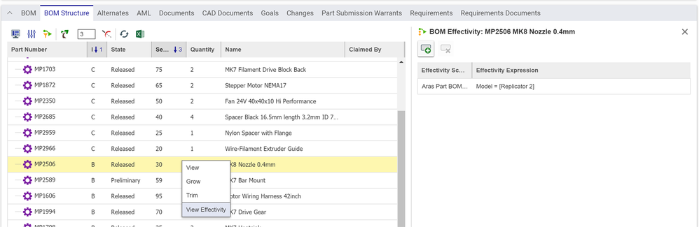

Because we've already covered how to author and resolve on effectivity in our previous blog post, we'll instead focus this section on pointing out how our now two existing Effectivity Scopes will interact. To begin, we'll open up a Part BOM that has a few relationships and, more importantly, has some effectivity already defined under the default Aras Part BOM Scope.
As a quick refresher, we can right-click and anywhere in the grid and select View Effectivity to open up a panel on the right of the grid. This panel shows us more details about the effectivity of a selected row and also lets us quickly and easily edit the effectivity of the selected BOM.

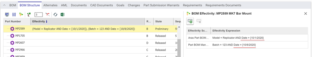

Authoring Effectivity for Two Scopes on One BOM

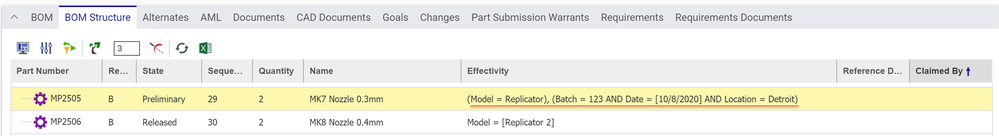

If we take a look at the Effectivity editor, we'll see that there's an existing row describing an effectivity condition for the Aras Part BOM Scope. We can easily add a new row here to define another condition under our new scope.
- Click on the button to add a new row
- In the Effectivity Scope field, enter Part BOM Manufacturing Scope
- In the Effectivity Expression field, enter some expression such as Batch = 123 AND Date = [10/8/2020] AND Location = Detroit
- Click Apply to save this condition
We'll see that in the Effectivity Pane, a new row was added with our provided effectivity criteria. Additionally, we can see that there is now a comma separated list in the main grid showing all of our effectivity criteria together.
As a note here, it's also possible and sometimes encouraged to add multiple rows of effectivity criteria for the same scope. In our example, perhaps this same part is used in multiple different batches that were created on multiple different dates in multiple locations. We could write this using only one very long expression but that added complexity could quickly make it hard to maintain. Instead, we could just add a new row for each batch.
- In the Effectivity Expression field, enter some expression such as Batch = 234 AND Date = [10/15/2020] AND Location = Detroit

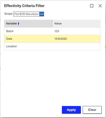

When we choose to filter the results, this BOM will be returned if either of these expressions match our criteria. For example, if we choose the filters below, the item will still be returned when the BOM is resolved because it matches our first effectivity condition.

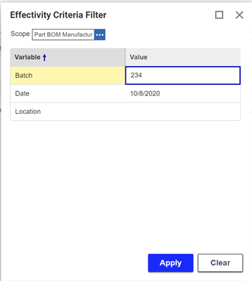

One thing to keep in mind is that each expression on the item is treated as an individual entity even if they both belong to the same scope. For example, we can select the filters below where the Batch matches one of the expressions and the Date matches another, but the combination of Batch and Date does not match any of the expressions.
If we apply this criteria, we will see that the BOM is not returned when the structure is resolved.
Two Effec Scopes with the Same Variable

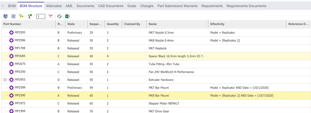

At the beginning of this design process, we decided to re-use the Date variable from the default Aras Part BOM Scope for our custom scope. In practice, this effectively functions as if there were two different Dates. Let's look at a BOM that has two different expressions: one for each Scope.
Now if we try to resolve this structure under our Part Manufacturing Scope with the date 10/1/2020, we'll notice that the BOM is not returned when the structure is resolved. While this BOM does have an expression referencing 10/1/2020, it is only valid under the Aras Part BOM Scope. Similarly, if we try to resolve this structure under the Aras Part BOM Scope with a date of 10/8/2020, the BOM will also not be returned.
