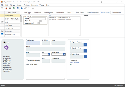

1. Import External CSS Stylesheet
Importing an external CSS stylesheet
Defining your form styles in an external CSS stylesheet can make maintaining many forms much more manageable. It's also a fairly simple approach to implement in Aras:
  1. Add or create your custom CSS file in the customer folder in your Aras code tree: [Install Path]InnovatorClientcustomer[file].css
  2. Log in to Aras as an administrator
  3. Open up your form in the Form Editor
  4. Under the Form Body tab, edit the CSS property and add import statements for default.css and your custom CSS file.
gist.github.com/.../ef67ecd7bd00303ec8d5651f81a71982
Importing the default.css file ensures that the default Aras styles are applied to your form. This is important for basic formatting and layout. Importing your custom CSS file after default.css ensures that your rules will override any conflicts in the default Aras styles.

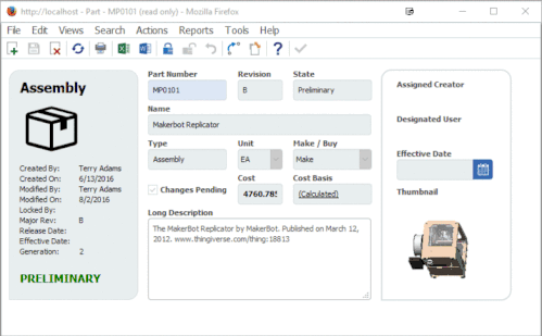

2. Override Default Label Style
Different label styles implemented via external CSS
One way to customize field labels is to set the properties under the Field Label tab for every form field. However, if would be easier if we had way to set and maintain the style of all field labels in one place. With a little bit of Javascript and a little CSS, we can do just that.

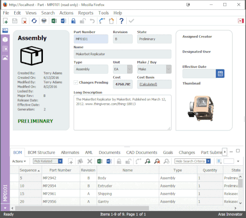

3. Customizing Field Styles
Default vs custom field styles
Now that we've seen how to import external CSS and how to override default styles with CSS/Javascript, we can combine these skills to customize our form field styles. Overall, the basic steps are similar to overriding the default label style. We will again define a new style in our external CSS stylesheet and then update the form field elements with Javascript. However, the Javascript we use varies depending on field type.

Text & Textarea Fields
For text and textarea fields, we can simply replace the default classes with our custom class.
gist.github.com/.../106d2093c1989ac001767d01ee6962bb
Date Fields
Date fields are composed of two parts - an input element for displaying the field's value, and an input element that acts as a button for triggering the datepicker dialog. Our Javascript will update the class of the input that displays the field value, and replace the source image of the "button" input field.
gist.github.com/.../7887688ca131ec58dd3257e69bd5ef62
Item Fields
Like date fields, Item fields are composed of two input elements elements. The following sample code updates the "button" icons with icons from GitHub's open source Octicon icon set.
gist.github.com/.../2347bb9ce9b4df6209b35792c08104c2
