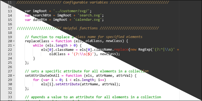

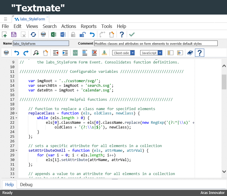

Six different themes in the Aras Method Editor: Textmate (default), Ambiance, GitHub, Idle Fingers, XCode, and Monokai.

To change the theme of the method editor, we need to update InnovatorClientscriptsCodeEditorMethodEditor.html. As shown in the code snippet below, you will need to replace "textmate" with the name of your chosen theme.
Note: If your theme name includes spaces, replace the spaces with underscores. Ex: "Tomorrow Night Bright" becomes "tomorrow_night_bright".

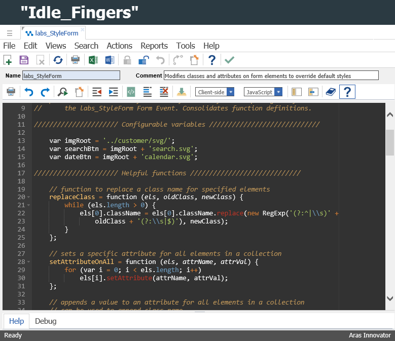

My personal favorite theme, "Idle Fingers".
