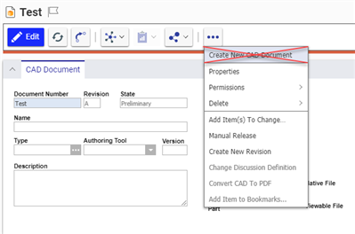

In our example, we'll imagine that we've just received a requirement to prevent users from adding CAD items through the Aras Innovator UI since we expect that all CAD items will be created via a CAD Converter. We can't simply remove the Can Add permissions from the ItemType because our users still need those permissions to add items through the converter. To satisfy this requirement, we'll instead remove the Create New CAD Document menu option from the CAD form using CUI.

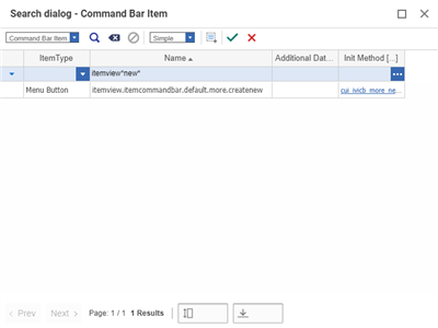

A Command Bar Item represents an individual UI component like a button or a keyboard shortcut. Because our goal is to hide an existing button, we're going to add a relationship by picking an existing Command Bar Item. In general, standard CUI items will follow a naming convention like LOCATION.PARENT_MENU.PURPOSE. For example, we're trying to find the item that represents the Create a New Item button. We also know that the Location is called ItemView.ItemCommandBar, so we can try searching for itemview*new*.
It's the first result with that search criteria! Let's pick this item, and then configure it to be removed from the UI for all of our users.
  1. In the Command Bar Item relationship tab, pick a related item
    1. name - itemview.itemcommandbar.default.more.createnew
    2. Action - Remove
    3. For Identity [...] - World

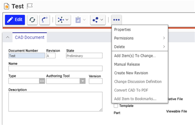

Once our changes are made and saved, we can see them in action by opening up any CAD item and trying to add a new CAD.
