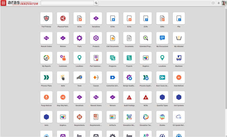

We will begin by logging in as Mike Miller, we can see that upon login we are greeted with a page containing every single ItemType in the TOC. Let’s say, however, that Mike is a manager in your organization. He does not need to see every single icon upon login making it harder to find the ItemTypes he frequents the most.

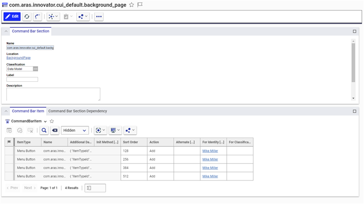

5. Here we will see two relationship items Data Model and Method, open the Data Model one (we can confirm this is the CUI element we need to edit since its location is BackgroundPage)
6. Click the edit button and then the select items button in the relationship grid below to add a commandBarItem
7. Search by name *EDR* and select the action Add and Mike Miller for the “For Identity”
8. Repeat step 7 to add ECR, ECO, ECN, and PR
9. Once you have added all of them, hit the Done button and logout

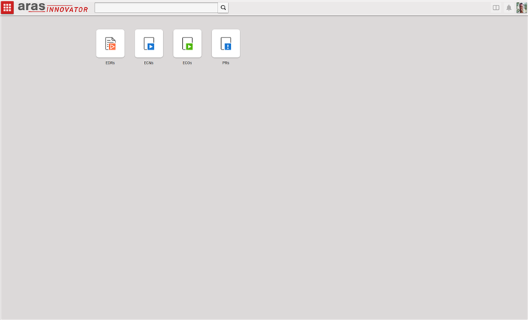

10. Sign back into Aras Innovator using the Mike Miller and we should see only the items we selected. It should look like this:
