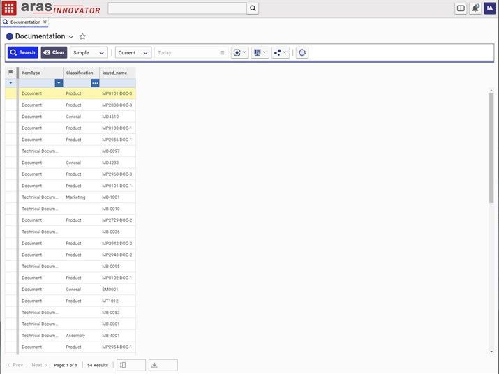

Let's start with steps from the previous blog post, specifically the section titled Creating Our Poly Item. Once you have created and saved your Documentation Poly Item, move on to the next section, The Result, to set the searchable column properties. Please note you should be logged in as admin. The result will look like this:

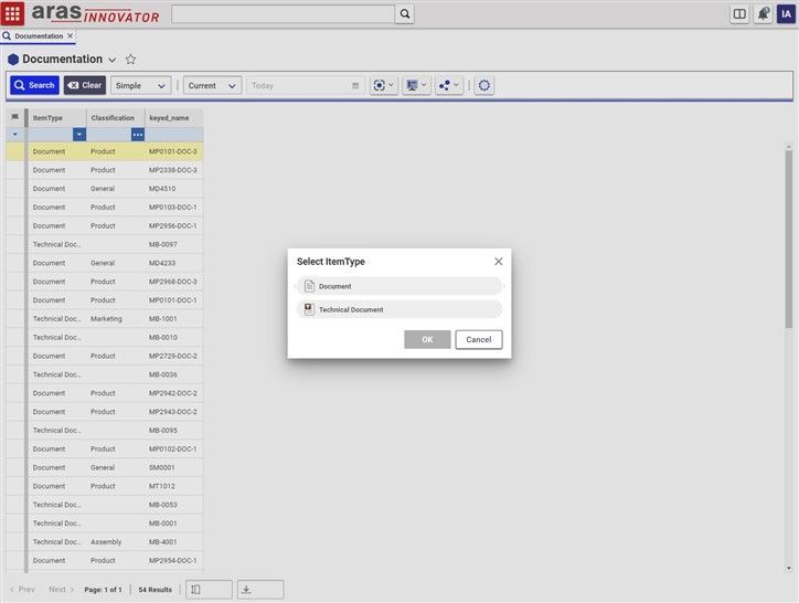

Go ahead and open the TOC, select the Documentation ItemType, and then the create new button at the top right  . This will bring up a dialog allowing you to select which ItemType you are creating.

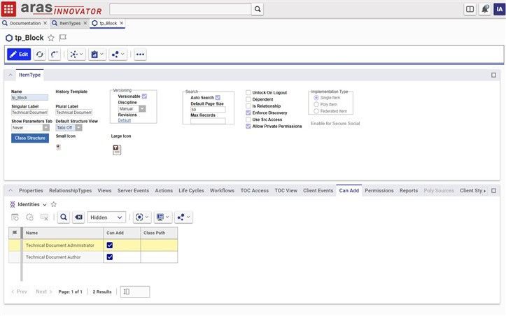

  • Go to the TOC > Administration > ItemTypes > then search for tp_Block
  • Choose an Identity other than Super User and Innovator Admin, in our example we will be using Terry Adams from the demo environment

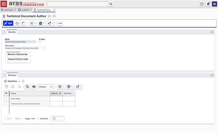

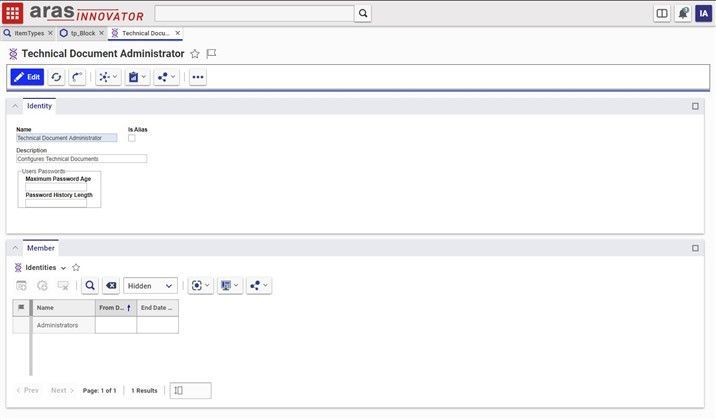

  • Click the relationship tab Can Add and open up the identities, make sure we do not have the identity you have selected (in our case Terry) configured on any of the identities.
