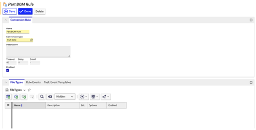

  1. Begin by creating a Conversion Type and calling it Part BOM
  2. Next create the Conversion Rule and call it Part BOM Rule setting the Converter Type as Part BOM. Let’s also set up the Cutoff value as 1 so that if we are testing and there are failures the Conversion Server does not run excessively in the background.
  3. Should look like this:

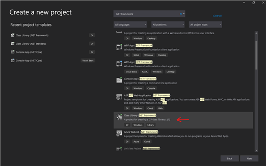

  2. Open up MS Visual Studio (we are using 2019 in our example) and select Create New Project from the menu.
  3. Search for .NET Framework and select the Class Library (.NET Framework) for C# class library(.dll).

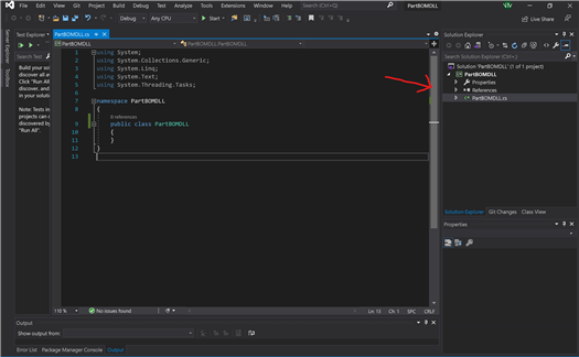

  1. Now on the right side of your newly created project there will be a Solution Explorer. Right click on Class1.cs and rename this to PartBOMDLL.cs and say yes to renaming the project all the references for Class1.
  2. This is what it will look like:

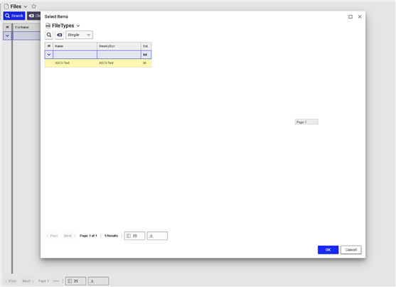

  2. Once that completes open up the TOC > File Handling > Files
  3. Search by FileType:
  4. In the results for the File search grid we will see the partBOM.txt file and its location meaning that it was successfully add to the Vault
