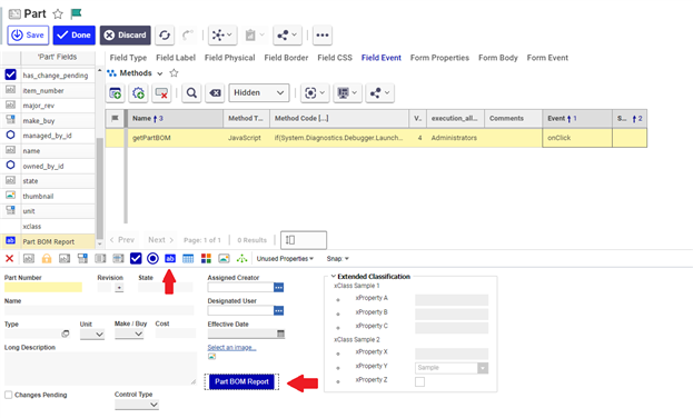

In order to get the Part BOM names we will need to add another method triggered by a button we will configure on the Part form.
  1. Create another new method and call this "getPartBOM"; set this to Client-side Javascript
  2. Add the following code:
  3. gist.github.com/.../52883efe0b56998d9d2f5587b1393cdb
  4. Open the TOC > Administration > Forms and search for Part; then open it
  5. Hit Edit and in the editor add a button
  6. In the Field Label tab give the button a name “Part BOM Report”
  7. Go to the Field Event tab and select the add method button, then search for and add our "getPartBOM" method
  8. Select onClick for the event and hit the Done button to save the form

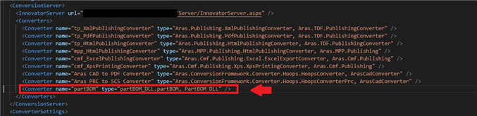

Last we will have to configure the ConversionServerConfig.xml in the root directory of your Aras Innovator instance (same place the InnovatorServerConfig.xml is found):
  1. Open this file up and we will need to add a Converter tag to the Converters section
  2. This will be in between the <ConversionServer> <Converters> tags as shown below:
Note we will be intentionally leaving out the DLL code for the purposes of just going over setup. If you would like to add your own custom DLL’s check out the “Example for Developing Conversion Server Tasks.pdf” in the CD image, specifically section “3 Creating the Example Converter DLL” to correctly create the Converter Class and “3.2 Build and Deploy the DLL” to create the DLL files.
