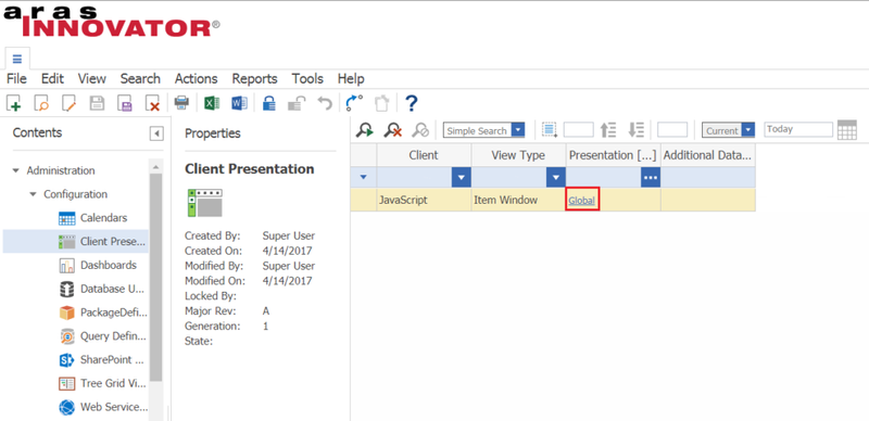

  1. Navigate to "Administration->Configuration->Client Presentation" and click the hyperlink highlighted below to open up the Global Presentation Configuration
    • Changes made to the Global Presentation Configuration will be applied to all items. It is possible to make ItemType-specific UI changes which we will explore in a later post

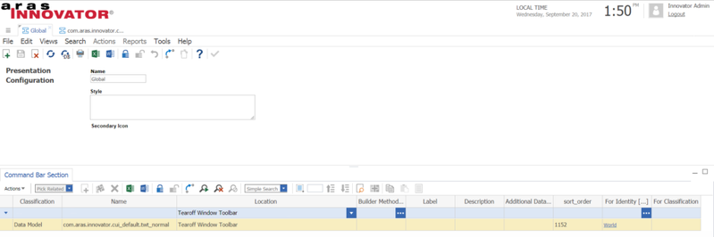

  2. In the Command Bar Section relationship tab search for the item below
    • Classification: Data Model
    • Name: com.aras.innovator.cui_default.twt_normal
    • Location: Tearoff Window Toolbar
  3. Open this item

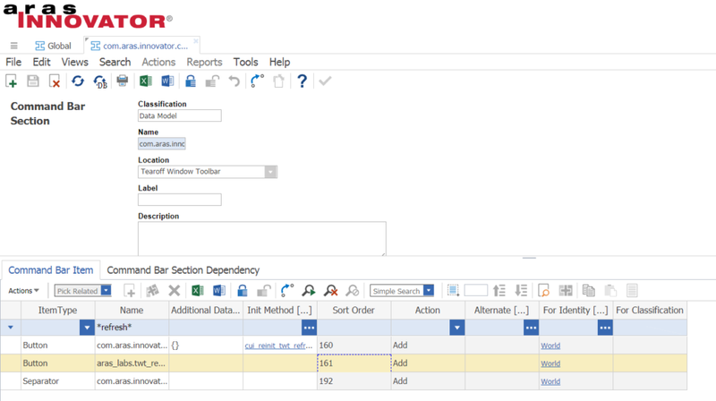

  4. In the Command Bar Item relationship tab, create a new item with the following information
    • ItemType: Button
    • Name: aras_labs.twt_refresh_from_database
    • Sort Order: 161
      • This will place your custom button next to the default refresh button
    • Action: Add
    • For Identity [...]: World
      • This is the Identity or Group Identity that will be able to see this custom button

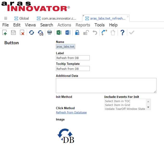

  5. Open this new button in a separate tearoff window
  6. Fill in the following information
    • Label: Refresh from DB
    • Tooltip Template: Refresh from DB
    • Click Method: RefreshFromDatabase
    • Image: RefreshFromDatabase.svg
      • Alternatively, you can use a standard icon or your own custom icon
  7. Save, unlock, and close this Button

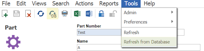

This button will be visible the next time that you log into Aras Innovator. To confirm that this works, open any item and confirm that you can see an additional button from the toolbar. If you use the icon provided in the project on GitHub, the tearoff window toolbar should look similar to the one below.
