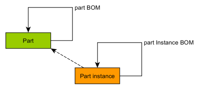

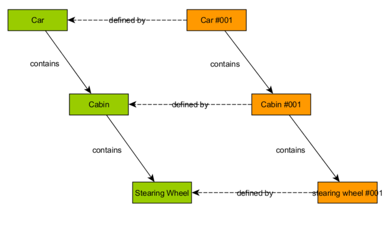

Here is the intended configuration. We start from the native part and part BOM to create a similar structure with every instance having a "definition" reference to their original part.
Here is the data model representation (the dotted line being a property of type item).
