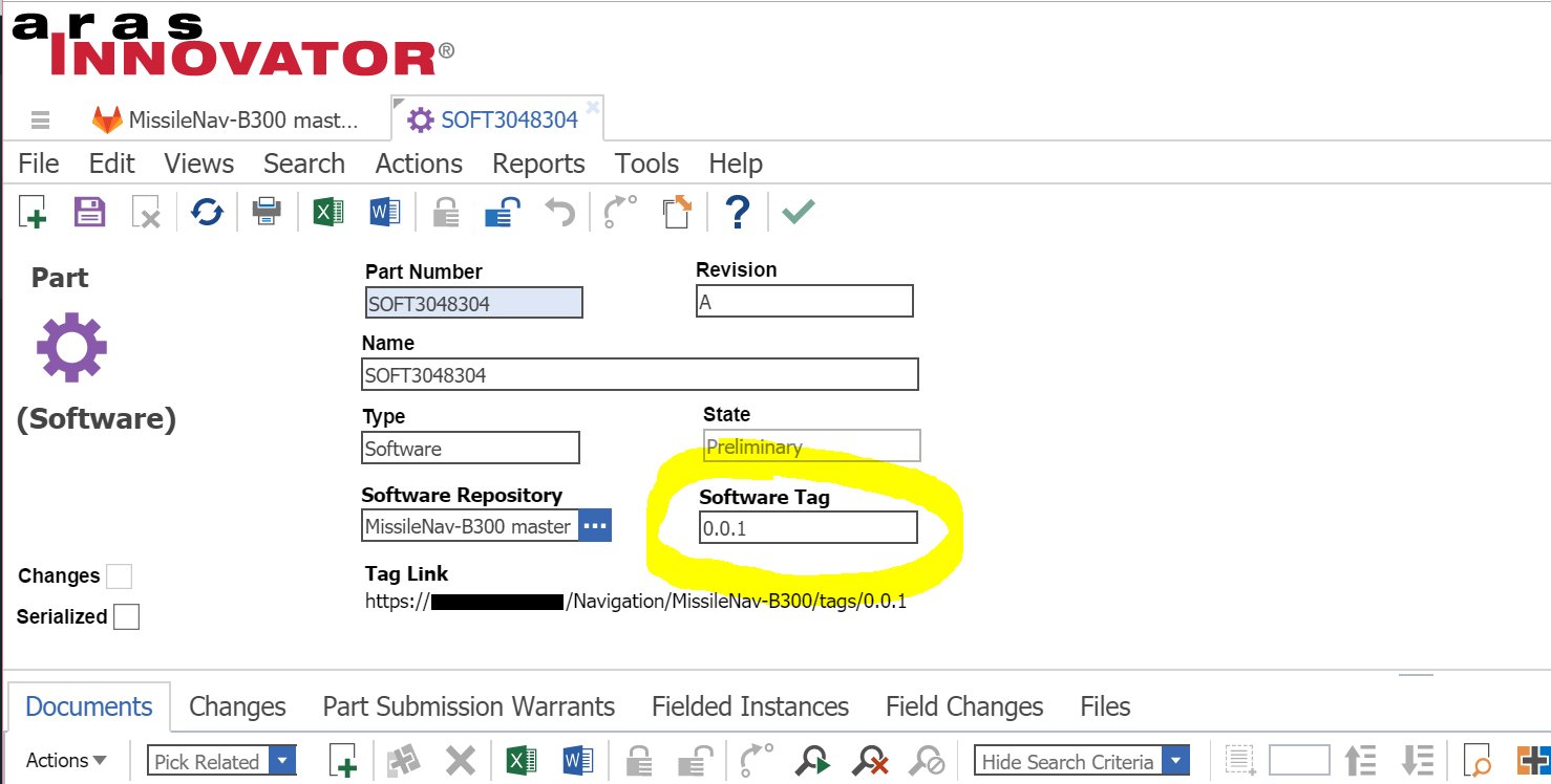

On Parts with the "Software" classification, there is a relationship to the Repository Item. There's also a Software Tag property in order to have a fixed relationship to a specific tag when a product structure (containing this software) is released.

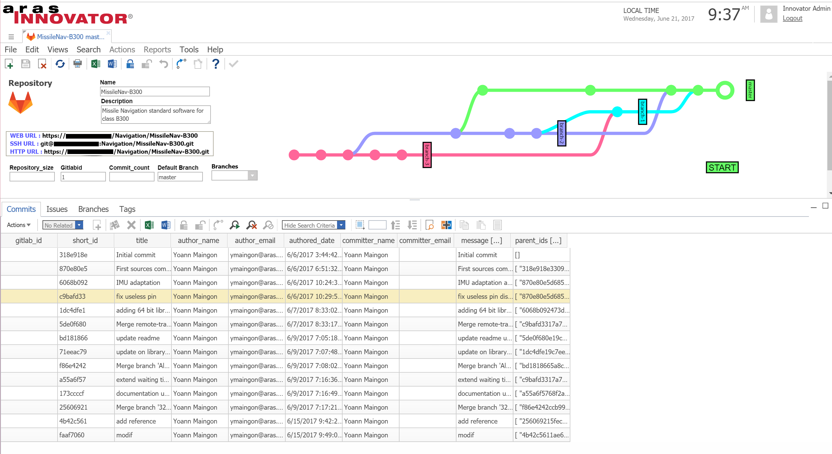

Repository View
Part (Software) View
