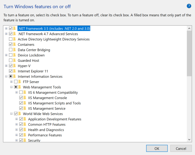

Windows 10
The steps outlined below are for a Windows 10 laptop. The steps should be similar if you're running an older version of Windows.
  1. Go to Control Panel > Programs and Features > Turn Windows features on or off. A dialog will appear with a tree of features displayed as folders.
  2. Enable all of the contents in the .NET Framework 3.5 folder.
  3. Enable all of the contents in the .NET Framework 4.7 folder.
  4. Expand the Internet Information Services folder.
  5. Expand the Web Management Tools folder and enable the following features:
    1. IIS Management Console
    2. IIS Management Scripts and Tools
    3. IIS Management Service
  6. Enable all of the contents in the World Wide Web Services folder.
  7. Click OK to install/configure windows features for IIS.

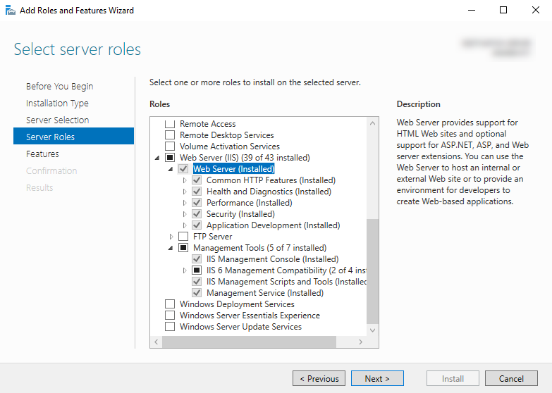

Windows Server
These steps are for installing IIS on a machine running Windows Server.
  1. Open the Server Manager.
  2. Click Add Roles and Features.
  3. On the Before You Begin page of the manager, click Next.
  4. On the Installation Type page of the manager, select Role-based or feature-based installation and click Next.
  5. On the Server Selection page of the manager, select the server or virtual hard disk you want to install IIS onto and click Next. The options will vary depending on your server's configuration.
  6. On the Server Roles page of the manager, expand the Web Server (IIS) group.
  7. Enable all roles under Web Server (IIS) > Web Server.
  8. Expand the Management Tools group, enable the following roles, and click Next.
  9. On the Features page of the manager, enable all features under .NET Framework 3.4 Features.
  10. Enable all features under .NET Framework 4.7 Features and click Next.
  11. On the Confirmation page of the manager, confirm the roles and features you selected and click Next to install.
